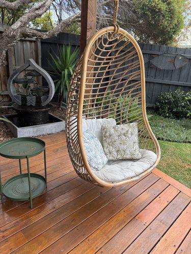

I can vouch for the Rusto-Oleum product @JacobZ recommends. I apply two coats at the start and end of summer on our hanging chair. It gets quite a bit of weather from hot winds to rain. This product doesn't yellow and dried very quick. I just wish I applied it the first time a little sooner as the cane had already started to blacken in parts. But its also helped to bind the cane tie strips in place, which can be a real issue with these chairs.
