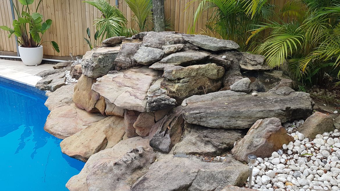

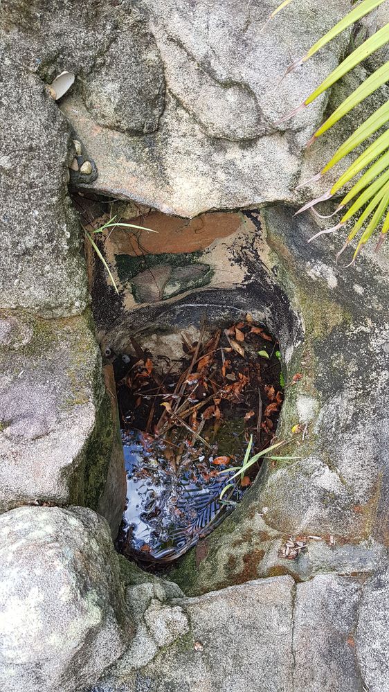

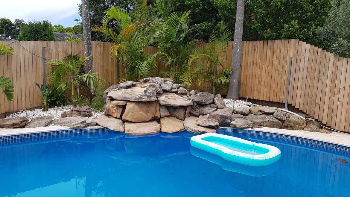

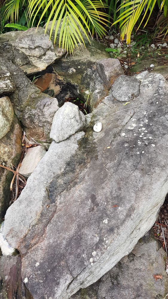

My son recently bought a house with a great water feature flowing into the pool. There are three water pipelines that return from the filter. the third one empties into a hole that is not sealed and the soil at the bottom absorbs the water. It does not flow. We assume it was not always like that. We need to fill the hole but try to keep it looking like all of the feature. It may need guiding rocks or stones once the hole is filled, and with what ?

1 the pool and rockery/water feature
2 Right side where hole is.
3 The hole, and top left, the white plastic pipe for flowing water.
4 The hole

It looks like the designer was tring to make three cascading water falls and the third one the hole is a mini plunge pool which will made a pleasing gurgling sound. Pools and ponds make great white noisy that helps dispurse city background noises I incorperate such water falls to create different sounds for that purpose.
So your plunge pool isnt filling and flowing? Wheres the water going then ummm
A super simple solution is to block /cap that outlet so no water goes out that way.
Any how it is simple to fix to try have all three water features running is sealing the bottom if this is all you need. This also works to seal around gaps in the rocks and you can build up its shape to redirect water like rock.
I am talking water proof sealed cement. Just mix it up to toothpaste consistancy and pour it in to the hole (after all the leaves and gunk cleaned out.) them smooth it out at the egdes to make a cup shape.
Clear the leaves and stuff out of the way down stream of the cup and add concrete to fill holes and redirect possible water flow as you desire to return water to the pond. Add cement shape it and leave to set.
2 Big shovel sand cement pre mixed with Bondcrete 400ml (water proofing) add water to make cement toothpaste like wear gloves us a garden trowel to spoon it in to position.
If to wet add more cement.

Thanks for the advice, I think you missed the fact that I noted that water wasn't flowing as it was absorbed by the earth in the hole. So you are saying that the hole WAS meant to be there, and just has to be sealed so the water flows. The information on using sand, cement and bondcrete to ensure it is waterproof is the answer I was looking for.

Sounds like you need to clean out that hole and fill the bottom with cement. Pop a rock on top of the cement in the bottom to hide it. Water weeps through cement but does the same with sandstone, which the entire feature is made from. So, I wouldn't be too concerned about it being entirely waterproof. However, you could use Pond seal to seal the area, but you'd need to do that the whole way down the "falls".
I think @Jewelleryrescue is saying the larger cavity is designed to be there as a deep trough at the beginning of the falls, but the hole in the bottom of it obviously isn't. You'll just need to clean the area out and patch the bottom of it so the area holds water once again.
