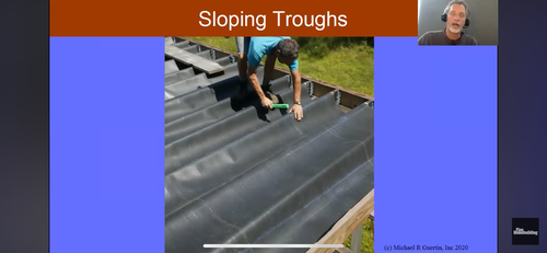

Hi Simon55. I actually ended up scrapping my original waterproof idea with mounting panels underneath the decking. The main reason being that decks are meant to be open underneath to allow air flow/ventilation to prevent rot.
I ended up doing a membrane system involving rubber pond liner. I unscrewed all decking panels, cut pond liner and stapled this to the joists (cut in a fan shape to enable fall), installed a gutter system to take the water away, re-screwed the decking.
I didn’t take progress shots along the way but have linked a couple of videos that illustrate it quite well. One of the videos shows the pond liner being laid in one large sheet. I suggest measuring the width of your joists and cutting the pond liner to suit each one. Takes more time but helped ensure a consistent fall for each section.
You could do this as well and then mount some colourblind sheets underneath so when sitting in the man cave, you’ll see the sheets as opposed to the pond liner.

Thank you very much for that update. It's good to hear that you've managed to cover the bottom of your deck in another manner. Let me tag @simon55 to make them aware of your recommendations. I love that the pond liner doubles as a joist protector as it keeps the frame of your deck dry. This should add years to the service life of your deck.

I have seen the way @Bubbles8712 has suggested and that looks liek it wiorks (Its how I would approach it myself)
