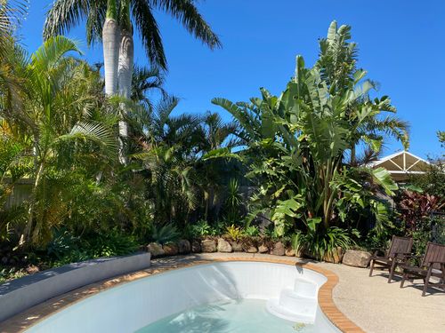

Hi experts,
new to the group seeking advice please. We are having a new pool installed as ours cracked in the recent flooding. All of the existing plants are going but i will keep the giant bird of paradise and the 2 very tall king palms. I need to add drainage to stop the raised beds leaking into the pool area when it rains heavily. What would you recommend to secure the bottom of the two corners with the king palms to the left of the photo and the giant bird of paradise to the right? Should get a bricklayer to enclose? Ir is there a better way? And where should i add drainage?

It would look fantastic if you continued the existing border on the left the whole way around. You could likely do this with bricks, but using blocks might be more effective. If it was made deep enough, it would make an ideal location to sit by the pool in the shade.
Check out this amazing bench the talented @ProjectPete constructed in his poolside timber cabana with concrete bench project. Absolutely stunning.
Your drainage should be added behind the wall so that any water that hits it drops down and is carried away.
Thanks Mitcell, thats a great idea and would indeed have a practical use,.
would the drainage be okay to run to the floer beds off to the right in tge garden do you think? Or would i meed to connect to storm drain, thanks heaps ![]()
That really depends on the lay of the land behind your property and the amount of water that the drainage will be capturing @clarem. If it's going to be a tremendous amount of water, I wouldn't recommend diverting it into a garden area; instead, you should connect it to the stormwater.
