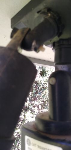

Hello Eric, I managed to remove the globe from the sensor light. It seems that the small white plastic pin that holds the sensor light socket to the arm has snapped in the middle and does not connect to the other side anymore. You can see the white stopper on the other lamp, in the lower half of the photo, which is missing....
PS - Maybe I could get the Gorilla Glue 51ml Clear Bottle to stick it to the plastic on the outside although it is quite heavy when the globe is inserted ???
I suggest trying to replace the white plastic pin with a Zenith M5 x 35mm 316 Stainless Steel Round Head Bolt And Nut - 4 Pack. You'll have to remove the old plastic pin and insert the new bolt and secure it with the nut at the end. However, if the pin is stuck you can't get it out, your only choice is to use Gorilla Glue 51ml Clear Bottle.
I suggest using masking tape to hold it together until the glue dries. Don't put the bulb in until the glue is cured. Putting the bulb in too early will result in the fitting falling again.
