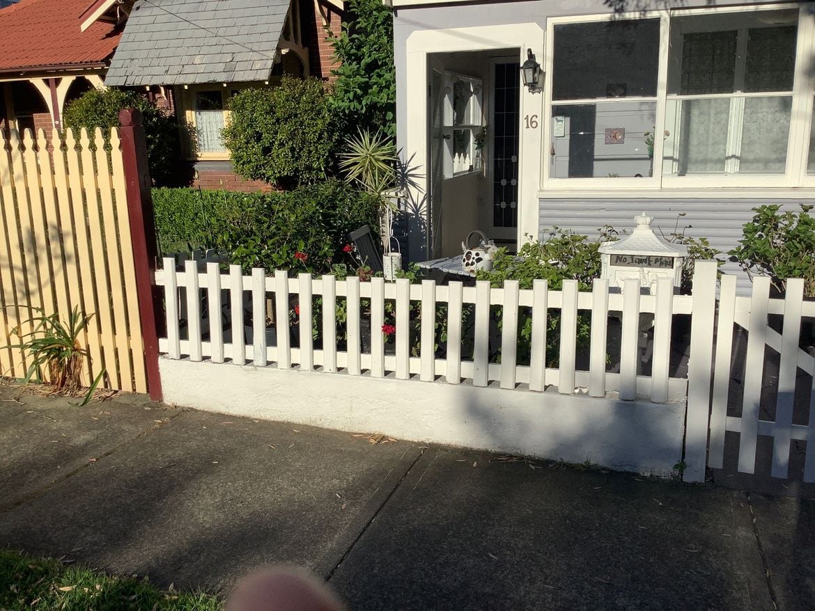

I am replacing the old timber fence and wondering what size railings I should use And whether it should be hardwood or treated pine. The span is 2.8 m and the actual pailing size will only be 50 cm Because of A small brick wall underneath.I will paint it afterwards

any reason you haven’t gone for the 70x35? A neighbours fence is the smaller railing… it is a bit shorter 2.4mtr, but pailings are over a mtr in length…
I’ve looked at a few fences and they all seem a bit different….

Yeah I hear you. The existing railings are hardwood but rotting now from the bottom and obviously centuries old LOL. Paint is what’s holding it together at the moment.
The new ones won’t have to last that long, but I will go for the thicker dimensions and that should last me out
