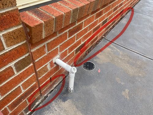

Thanks Eric. Another question for filling in the gap around the house (externally): can I use the same sikaflex 300ml to fill the gaps as in this image? Do they come in bigger tubes or containers?
Hello @MMehdi
To fill the larger gaps, I suggest using Moroday 15mm x 5m White Gap Filler Rod first and pushing it a maximum of 5mm into the gap before placing the Sika gap filler over it. I believe the Sika 11FC comes in a larger sausage pack - Sika 600ml Concrete Grey Sikaflex 11FC Purform. Please note that it will require a larger gun applicator.
