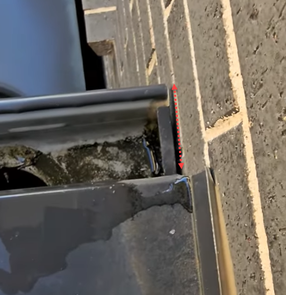

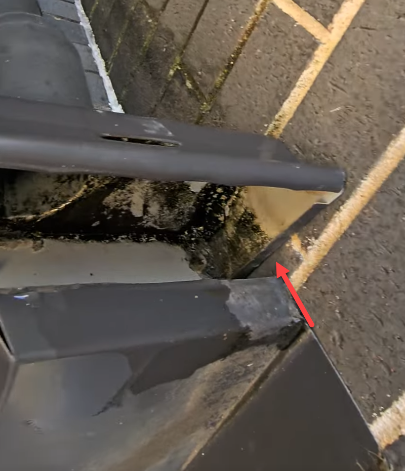

Hi Jacob,
I got a video of the drain from top. Like you suggested I got a cup of water and put in it there but could not be exactly sure where the leak was from. I have taken a video from top. Hope it helps to zero in on the issue.
Thanks.
Hi @sum1989,
There's a decent chance that the issue is because of water running down from the top, clinging to the brick wall and finding its way into the gap at the end of the gutter.
I'd suggest sealing up this gap at the end of the gutter with some Black Sikaflex 11FC Purform.
Blocking this gap should make the water find its way into the gutter. It may help to bend down the lip on the end cap a little bit to ensure it flows into the gutter.
Let me know what you think.
