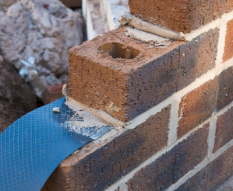

Hi Mitchell,
Thank you so much for your advice🙏
Do you have some sort of tutorials on how to install dampcourse layer?
Should I just lay it beside the wall and put a few bricks on top of it to make it fixated?
Your walls should already have a dampcourse layer in them @mike1360. The dampcourse layer is installed whilst the brick wall is being constructed, and it's a standard building practice required on all homes.
You might not be able to see it, but unless you've noticed moisture damage on your internal walls, I suspect a dampcourse layer is present.

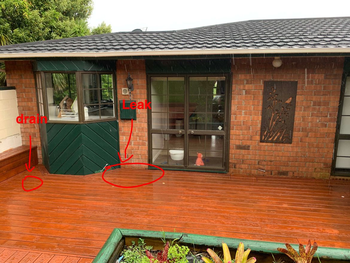

If I found a drain 2-3 mitres away from the affected concrete wall, how can I create a drainage solution to divert the flow of water away from the house? then lay polythene on the ground under the house to stop any water from travelling towards the concrete block
Hi @mike1360,
I'd suggest digging a trench 100mm wide a 450cm deep directly in front of the Besser block foundation that slopes toward the drain. You can then lay a slotted Ag-pipe in the trench and backfill it with drainage gravel. The Ag-pipe can be connected to a stormwater pipe and diverted to your drain. Any water travelling on the ground or under the surface will drop into the trench and be carried away by the pipe. Please note that you might need a qualified drainage professional to make the connection.
