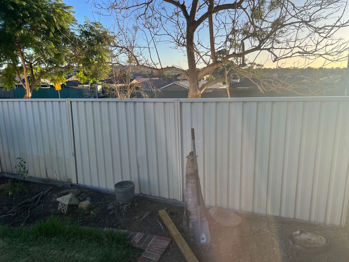

Hi

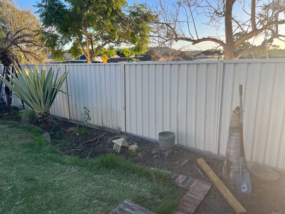

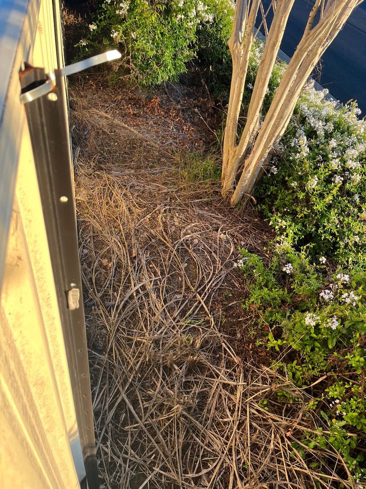

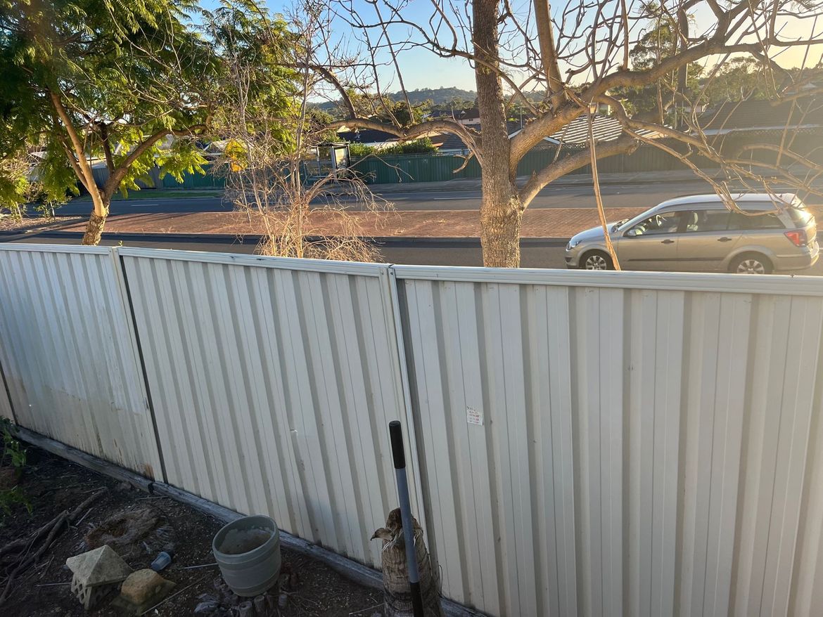

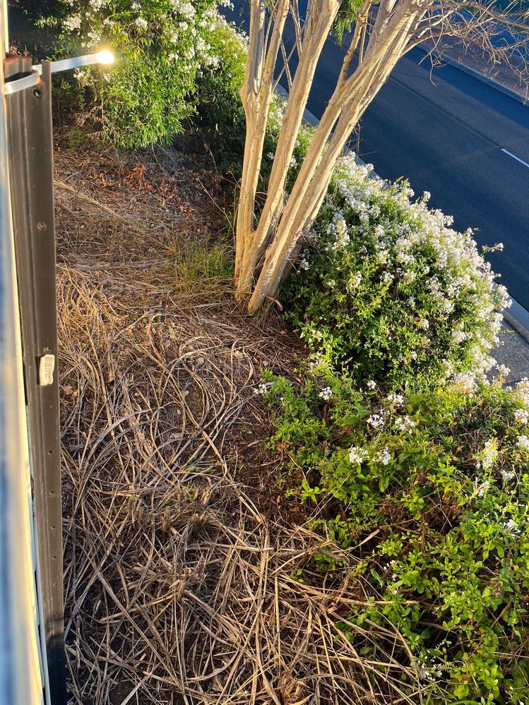

Our backyard colourbond fence located on a busy road and it wobbles when cars drive pass it and when it is windy as well.
It's colourbond and with 8 posts concreted in but the whole length of fence (7 panels x 2.3 = 16m) does like a wave as the wind hits it.
I bought two 2400mm metal Star picket stakes for temporary support.

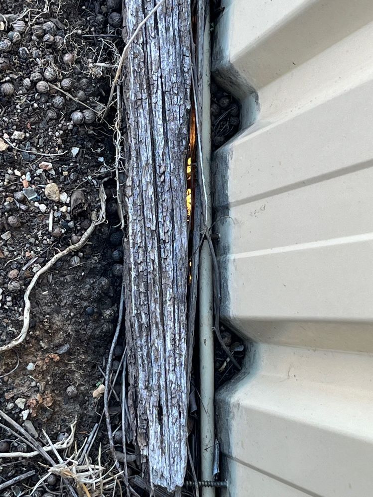

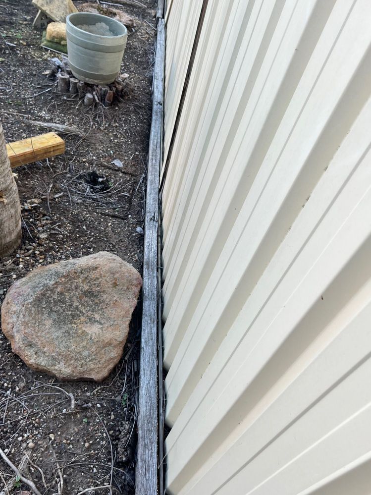

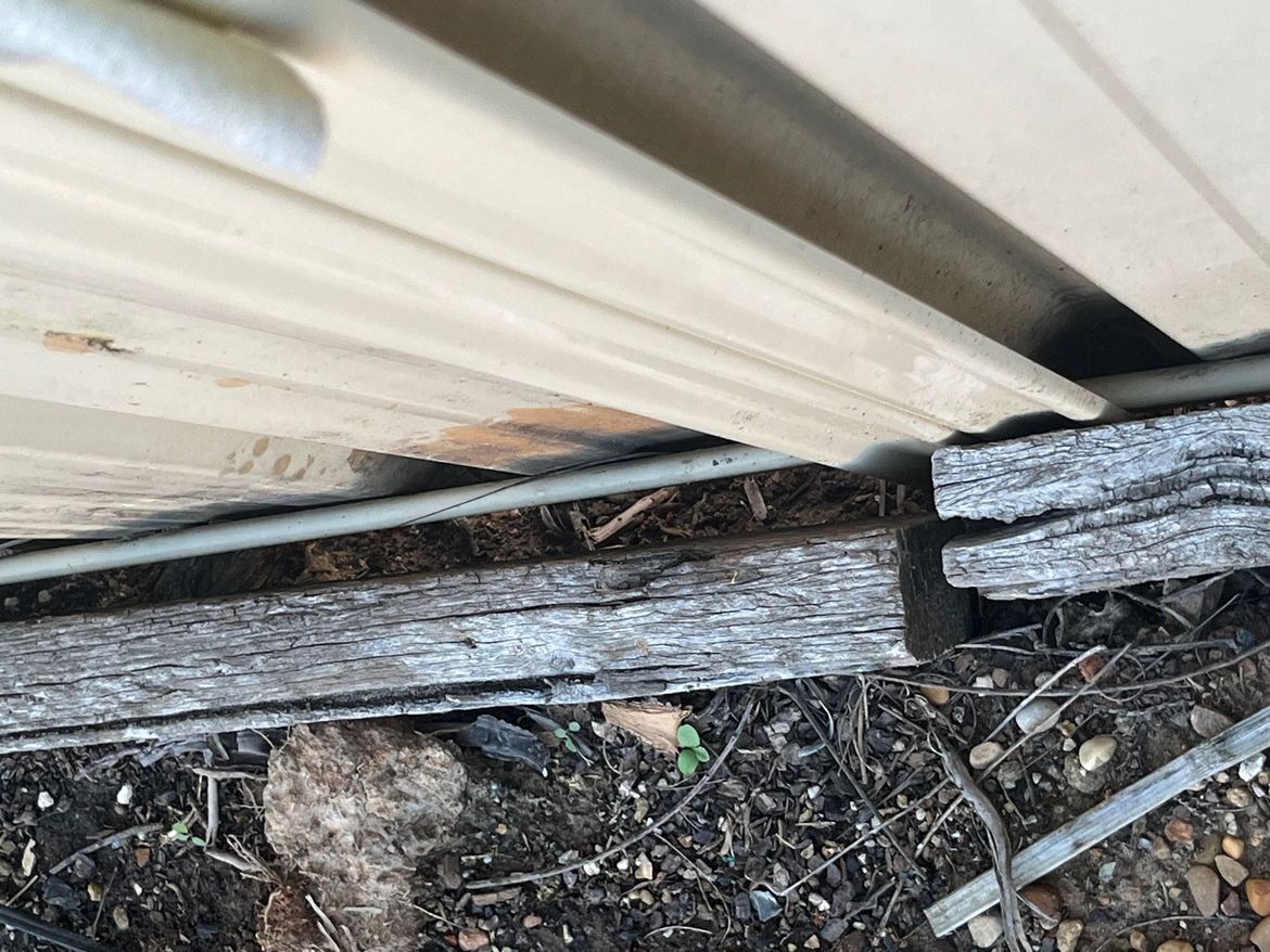

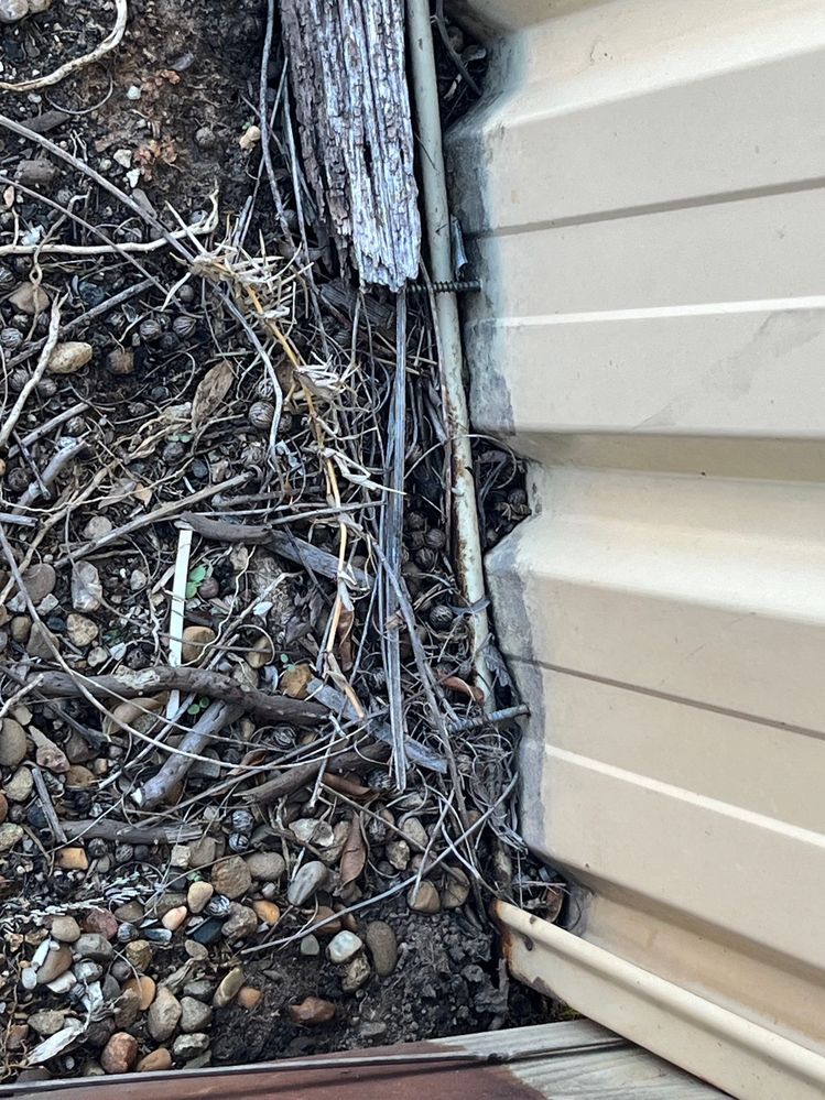

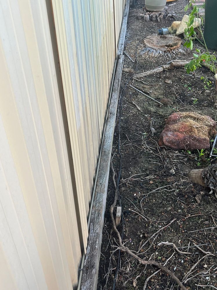

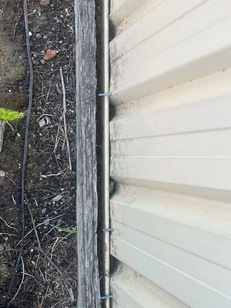

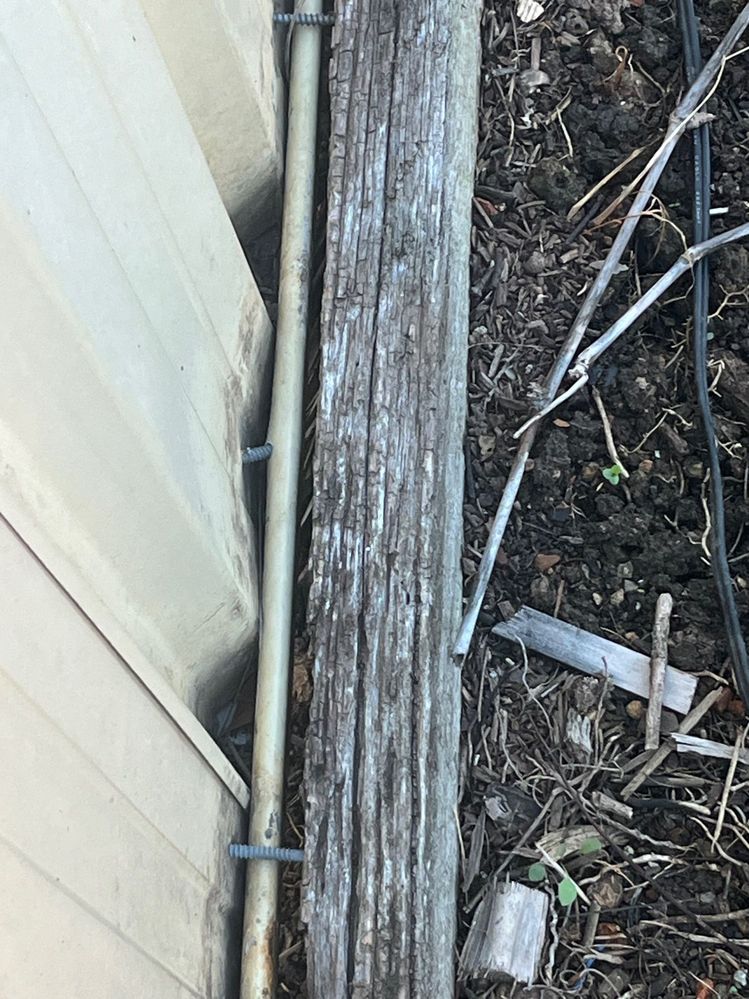

The fence is screwed to a timber boards on ground as can be seen on the attached pictures and they rotted
How can I brace it properly to avoid its falling ?
Thx
IMG_5735.jpgIMG_5736.jpgIMG_5737.jpgIMG_5738.jpgIMG_5739.jpgIMG_5740.jpgIMG_5742.jpgIMG_5743.jpgIMG_5745.jpgIMG_5746.jpgIMG_5747.jpgIMG_5748.jpgIMG_5750.jpgIMG_5751.jpgIMG_5752.jpg
Thx
Re: How to brace a colourbond fence that wobbles
Welcome to the Bunnings Workshop community @zillah. It's marvellous to have you join us, and many thanks for your question about supporting a Colorbond fence.
It sounds like you need to install some solid posts that can then be attached to the fence. I'd recommend using Australian Handyman Supplies 50 x 50mm x 2.4m Galvanised Steel Fence Posts and concreting them into the ground with sizable footers. 350 x 350 x 450mm would likely be suitable for the footer. I'd recommend at least one post per two panels. Ideally, it would be best to position these new posts next to the old posts, but the old posts' footers won't let you get close enough. You'll need to install them mid-panel and fix the top and bottom rails to them.
Did you have any success with the Star pickets? If so, you could potentially use several more of them.
Thx Mitchel
Appreciate the informative details
>>Did you have any success with the Star pickets? If so, you could potentially use several more of them.<<
i didn't feel they are sturdy
