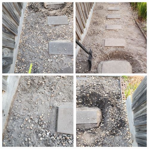

I’ve started removing most of the pebbles and have a few questions:
1. How much more of the pebbles do I need to remove?

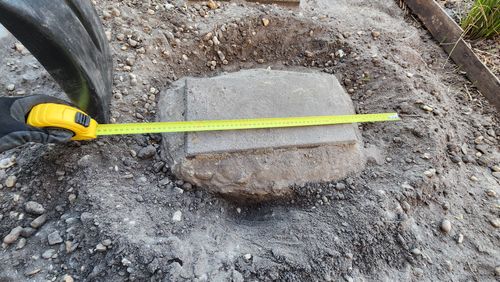

2. I’m concerned about the large concrete block beneath the ground—it seems quite substantial. It’s at least 25 cm deep and approximately 60 cm wide. Plus they are invery stable and level nicely. Should I go ahead and dig it out?
3. Once I remove the concrete blocks, what should I do with them? Should I arrange for a skip bin to dispose of them?

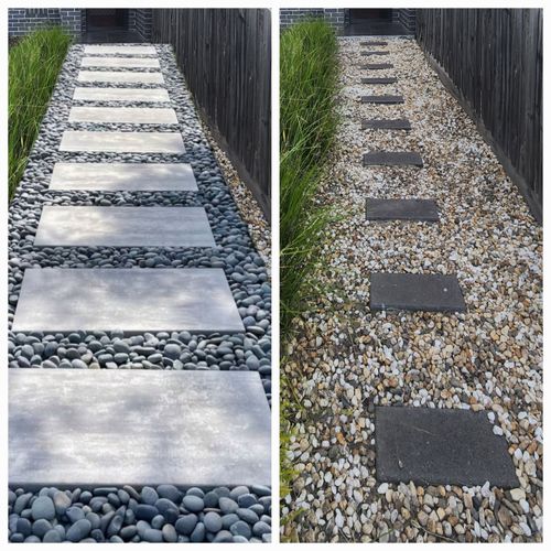

This is what I want my pathway and skipping stones to look like.

Given the substantial size of the concrete bases, you might like to add more concrete around it and install your new pavers on top. The additional concrete around them supports the edges of the new larger pavers so they don't crack.
You don't need to remove all the gravel, just the bulk of it. You should be fine to add your weed matting or geotextile fabric over the remaining stones.

Man that is a chunky footing to those pavers :smile: Id almost be tempted to cold chisel the old paver off and reuse the concrete base. Depends on how the surface looks once the paver has been removed.  Craftright 2 Piece Cold Chisel Set plus a ball hammer or pound hammer are the tools id use.
I like the idea or scraping back all the pebbles for a clean install. Having the surface smooth before laying down weed mat makes for an easier job with no high points in the ground (left over pebbles) to poke through over time.
