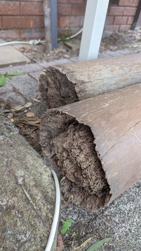

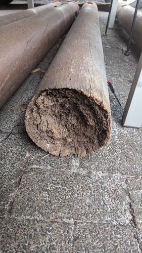

We picked up a Bali hut for free which we are hoping to put together over the top of our got tub. The only problem is the 4 posts are a little rotten on bottom and I was wondering what the best course of action would be to repair them or at the very least stop it from getting worse in the short term. I'm uncertain if I should be bogging it, cutting it and capping the ends etc.
Any advice would be greatly appreciated.

If you are re-using the posts, I suggest trimming off the rotted part of the post. The reason for this is to make sure that the footing of the post is good solid wood. I propose cutting off only the rotted part of the post, this of course will mean that you'll need to make a taller concrete footing to compensate for the part that you cut off.
I also suggest sealing the bottom of the post with Gripset Betta 1L Waterproofing Membrane Bitumen Rubber. This will protect the exposed section from moisture.

With your posts Id saw off the rotten part for sure, I would be tempted to put in L bracket stirrup posts making sure you dont rest the post on the base of the L (will stop water pooling that way) pryda 130mm m10 half stirrup post anchor There are also ones you can concrete in place but this is the idea.
Second way is to use otter 690 x 90mm ground screw stirrup instead of concrete and then still cut your pots plus square the base to fit.
Both ways means no more rotteing and can potentially add back that missing height from the rotted part. Id still seal it as @EricL suggests for sure.

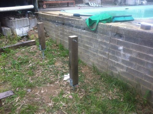

Thank you so much for your advice @Dave-1. Potentially stupid question but if you don't rest the post on the L, how would it be attached to/support the post?
Afternoon @Saigey
hahahahah no such thing as stupid questions, seriosuly there are not. It always helps someone even if its the silent person in the group that is worried about asking and just hoping someone else does. So with the L bracket or the full stirrup there are holes in the side to put screws or bolts through (I prefer bolts as I find they can be tightend better. This is what I did for my deck support posts at home. It stops the bottom of th post rotting. I used an offcut as a spacer while putting the posts in and then knocked it out when finished.
With the second photo you can see the bolts that I used. I suggested an L shaped stirrup as your posts are wide and you may not want to tim them down via saw and chisel is all. I would still make sure you have a flat edge against the post for the stirrup attachment point tho.
