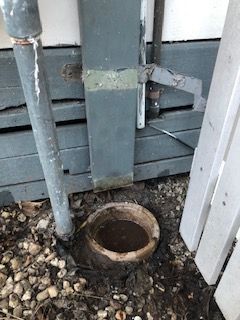

The stormwater pipe is full of soil but I'm not sure how far the blockage extends to. I have removed the small PVC outlet at the end of the downpipe to get a better look. I removed as much soil as I could and then filled the stormwater pipe with water to see if it would flow through and it did not. The pipe has a 90 degree bend and I think the soil is caught there. What tool could I use to dislodge the blockage (my arm can only reach so far). I suspect the blockage is only partial because further down (approx 4 meters) the stormwater pipe it is not blocked,

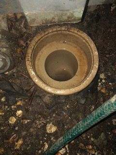

An update, I was successful in clearing some of the blockage with a mop used as a plunger. I can now put my arm down the first bend and it is clear of soil so water does flow to a degree. Now what happens is that the drain will fill as per the photo, it doesn't get any worse and the water does flow but slowly. About 6 metres down is a pit which shows that water does flow, yesterday that wasn't happening so today was a minor success. It raises 2 questions. 1. The blockage is now a metre down the line where there is a bend of some sort, do you think a wire drain auger will be effective in clearing this smaller blockage (a hose just seems to go past the small blockage without collecting it).

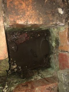

2. The pit does not have a cover of any sort, should there be some sort of grate and if so where do I get one.Pit
Water always at this level
