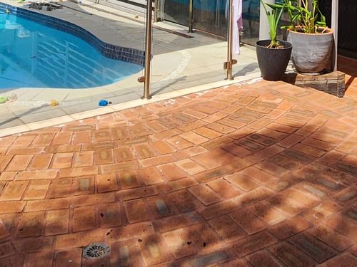

I want to spruce up our red brick pavers. I love the pattern so don't want to cover them but they get REALLY hot and hold the heat (we're in Darwin). Plus, there's some ugly glue stains from adjoining tiles
that would be nice to not see any more. I'm thinking a mortar wash could be nice to lighten the colour a bit without making it too glarey. But will that textured surface attract and trap too much mould? It needs to be pretty considerate of full sun, a lot of rain and not get slippery or mouldy.
Love to hear your thoughts, experiences or product recommendations.
Pic is of part of the red brick pavers and the adjoining tiles around the pool.

A mortar wash would give your paved area a fresh new look, but you'll need to be vigilant when mould or mildew start to grow on the surface. A lighter coloured surface will make any dirt or blemish stand out and easily seen. My only thoughts are to give the surface a thorough clean with a pressure washer in combination with 30 Seconds 5L Outdoor Cleaner Concentrate. As for the glue stains, I recommend manual removal using a Craftright 5-in-1 Scraper.
Once the surface has been cleaned, I propose using a sealer such as the Crommelin 1L Natural Finish Penetrating Sealer And Water Repellent. When the heat gets too much, I suggest putting down a Crystal Velvet 70x300cm Dune Rug Runner temporarily on the surface to save your feet from getting cooked. The rug can be rolled and put away once the sun goes down and the pavers have cooled off.

What about if I still want to pursue some kind of partial recolouring to freshen them up? I'm looking at options like a transparent tint, mortor wash or paint on that is then partially off while still wet, to leave that whitewashed look.
What products are available for that kind of effect?

There aren't any off-the-shelf products I'm aware of that are specifically designed to give that partially whitewashed, aged look on pavers — aside from doing a DIY mortar wash or limewash-style effect yourself. Most of the coating products we stock tend to fall into two categories: clear sealers, which preserve the existing look, or opaque concrete paints, which will completely cover the brick.
If you decide to go the mortar wash route, it's a hands-on job, but it can give you that softened, sun-faded effect you're after. Just be sure to test in a small area first, as the finish can vary depending on how porous your pavers are and how quickly the mix dries.
