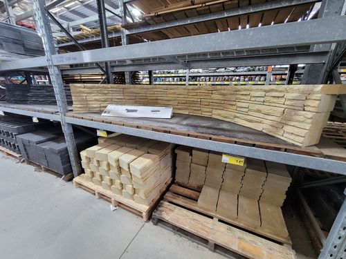

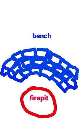

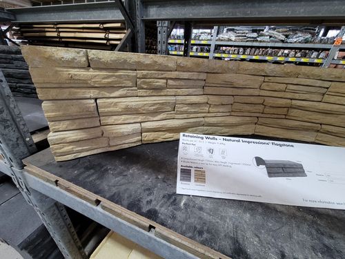

First time attempting this, I aim to construct a circular bench for seating around a firepit. The ground base consists solely of soil without any paving or concrete.
Anyone can confirm if the following procedure is correct 🫂:
1) Begin by preparing the base, excavating approximately 7cm depth of soil and replacing it with road base.
2) Compact the road base thoroughly.
3) Apply fast-set mortar to secure the initial layer of bricks. Considering adding three rows* of bricks to enhance stability.
4) Once the first layer is in place, proceed to stack additional layers atop the initial one. Utilize a caulk gun and liquid nails to adhere the bricks together.
