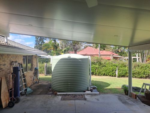

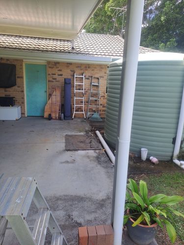

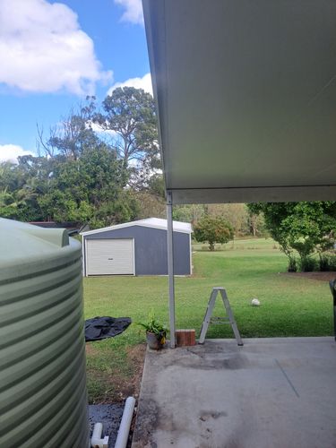

Hi all, I'm wanting to build an external stud wall with external sheeting/ cladding at one end of our patio. What is the best way to waterproof between the base stud and the concrete slab? Also would I need to put a membrane between the stud wall and the external cladding? TIA

I don't think I can add to much to what @JacobZ has already outlined as he's ticked of each point in addressing the external wall. Your only area left would be the overlapping roofline over the house roof tiles. I would suggest looking into a full length custom bent colourbond flashing sealed along the top of the alfresco roof down to the guttering. Its a tricky one to work out, but it just needs to be on the covered area of the gutter so the house roof water run-off isn't hindered.
