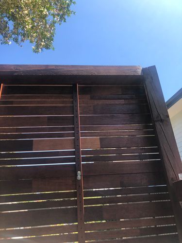

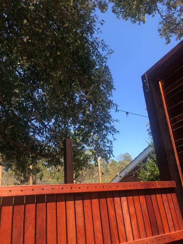

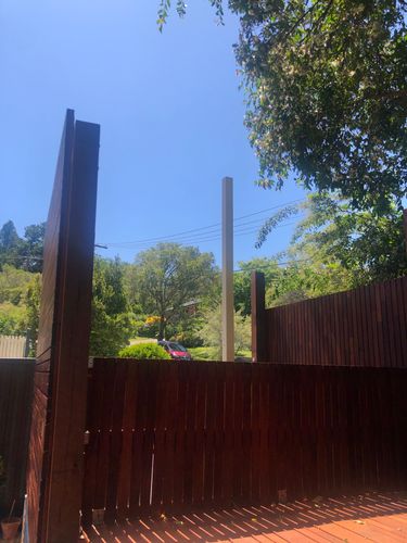

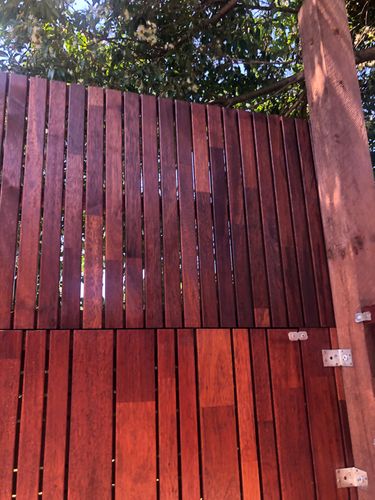

I purchased this item from Bunnings to install roofing for my chicken coop. Could you please let me know how to waterproof. perimeter of the roof as well as overlapping areas. The structure is timber post and the walls are merbau screen panels.

In order for us to give you a comprehensive recommendation, would it be possible for you to post some photos of your chicken coop? I just want to be sure that I'm understanding your question. Is the perimeter of the roof made of timber? Are you asking if you need waterproofing for overlapping panels?
HI @Marten
I am going to assume underneath the polycarbonate sheet is a timber frame all round.
Ideally you roof should be on a slight angle so the water runs off neatly and dosnt try to under under the sheeting.
But Suntuf makes water seals for your corregated roof panel the matches the undulations on the sides it is flat they also make 20mm foam . All this foam sits between the polycarbonate roof and the timber frame Then screw the sheet down with roofing screws with caps so the foam compresses a bit.

Some nice timber you have there just make sure your polycarbonate is supported by a frame underneath with some cross timbers to screw into as it can be lifted by the wind, this will let you foam seals work too.

Normally it is simplest to lay sheets on a flat frame with approx 50mm over hang. I even some times over hang the sides for (simple structures.)
Watch the attached video may help give you clues. The main issues is the get the water to run off away from structure.

Thank you very much for posting those photos of your chicken coop. It's great that you've received excellent suggestions from @Jewelleryrescue. I totally agree with their recommendation that a frame must be built first so that the Suntuf panels can be installed properly. The panels by themselves will not hold their own weight and they will sag and fall without a timber frame.
Having the Suntuf panel overhang is highly recommended as this will keep the timber frame dry. The Suntuf 20 x 20mm x 3m Back Channel Foam is inserted between the timber frame and the Suntuf panel.
