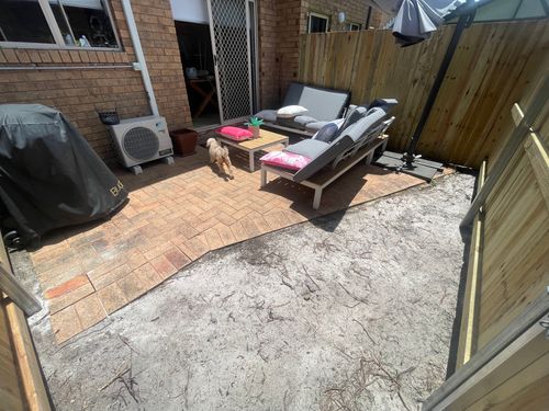

By whitewash do you mean that washed out white you see sometimes on old furniture?
Or do you mean painting the pavers a colour?
Are you also going to paint the concrete next to the pavers?
If its painting the pavers something to consider before you start is the reflectivness of the paint. I didnt know it existed until I painted my patio and yeah it made a difference in getting paint that reflected less.
Hi Dave
I mean paint them white, but give it a slighty washed look - so like a lime wash - not a hard out white
and its soil next to the pavers not concrete - and that will be full of plants
i am also going to be painting the fence you can see in the picture
Which paint did you use for your patio ?
Afternoon @cazbamford
That would look pretty nice I must admit ![]()
Whoops to the "soil" lol That will cool the yard down nicely!

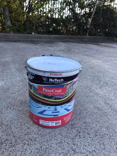

The paint I used was
I didnt get it through Bunnings tho. I did a lot of looking and trying to figure the best way to go forward as the patio had old paint that I had removed.
I dont like paint on concret as one day it will have to be removed/redone
But thats me. The concrete patio paint from Bunnings had 3 steps to do the job, this one was only two coats of the paint. It came up nicely and refelcts a lot less then the yellow/white/cream paint that was on the patio before. (You can feel the difference as you walk into the house)
With the pavers, I am not sure how I would paint them especially taking into consideration of moisture coming up through the paver itself? I am sure one of teh other members will have experience in that tho ![]()
Cheers - where did you get that paint from ??
Evening @cazbamford
It was from a local paint supplier (also that wa sthe smallest can I could buy) , if you check the name out of the can and have a look they will tell you if there is a local company that sells it near you. It just feels wierd to put external links into the Bunnings page
I dont think its frowned upon but "wiggles hand" for fairness ![]()
Hi @cazbamford
I lime washed my brick house and it does look great. Only thing to be mindful of is when it rains the lime washing almost vanishes. It comes back as soon as it drys but is unnoticeable in the rain/ when wet. I do have gray/white bricks so not sure how different it would be on red bricks.
Hello @cazbamford
Welcome to the Bunnings Workshop community. It's marvellous to have you join us, and thanks for sharing your question about whitewashing your outdoor pavers.
I suggest having a look at these discussions - Help to lime/whitewash driveway by @krawson and How to whitewash red brick paving? by @MaggieJ. You'll find in the discussions some fantastic suggestions on how to achieve the look you are going for.
My best advice is to make sure that the surface of your outdoor pavers are totally clean and dry before applying any of the products. Keep in mind that you are technically painting over a horizontal surface which means that its subject to dirt and debris being blown in. It will also get scuffed by shoes and furniture being dragged over it, periodic maintenance will be necessary.
