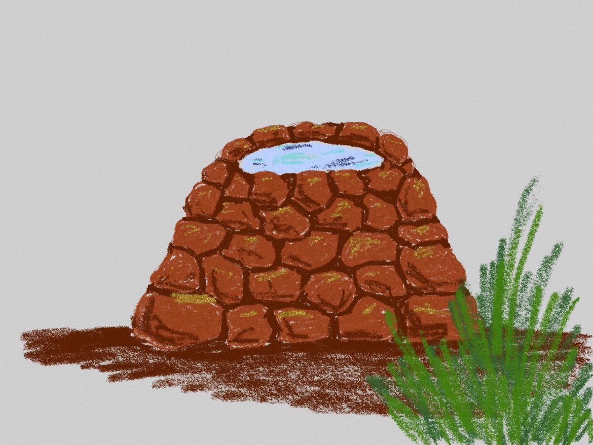

Hello, we live in an area with lots of coffee rock and would like to use them as a structure for a bird bath. What products
should we use? Is there an additive to make the concrete match the rocks?
We're thinking plastic or sealer might be necessary to hold the water but happy to manually fill and clean. Any tips appreciated ![]()

I suggest using a timber frame and building it in an octagonal shape. I propose using the RESPECT 60cm Light Grey Green Earth Tapered Low Bowl Planter as the bird bath itself. The best part is that you can take the bird bath out and give it a good wash when it gets dirty or you can install a small solar-powered pump to keep the water moving.
I propose using the bowl planter as a reference for your timber frame. The general idea is to build the frame and then cover it with cement sheeting. Once the cement sheeting is in place you can begin glueing the stones in place with mortar mixed with oxide.
