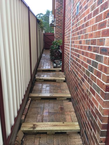

Actually I am looking for idea to change or fix the floor .
Hi @Amir,
There is certainly some movement going on which needs to be addressed. The first step would be to understand why there is movement and then correct the issue. Either some bricks are sinking or there could be large trees on the other side of the fence and their roots are pushing the bricks upwards. You need to remove the bricks and then level the area, compacting the base material might assist to stop the movement. If it is tree roots pushing up on the bricks any fix might only be temporary.
I'd be interested to know what the timber boards are being used for, do they have something to do with the issue?
You might be interested in the article How to lay paving for a path, to see the methods you'll need to use.
I'll also mention the talented @Yorky88 to see if he can offer some advice.
Hey @Amir it definitely looks like there could be some root action going on underneath your pavers. If I were you I would be pulling the whole lot up getting rid of any roots, compact it and bring in some brickies sand and re lay those pavers. I’d also be inclined to ramp the back section and get rid of those stairs and that should make that space a lot more user friendly.
