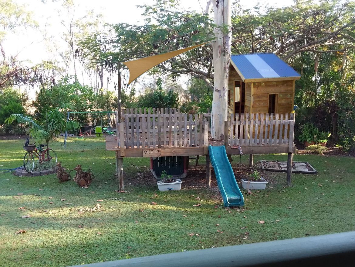

I've started on a tree house for the the grandkids. Now with summer coming on, I'm wanting to add some shade, although the trees are doing a lot of this the afternon sun is the issue, any ideas on simple sturdy cover?

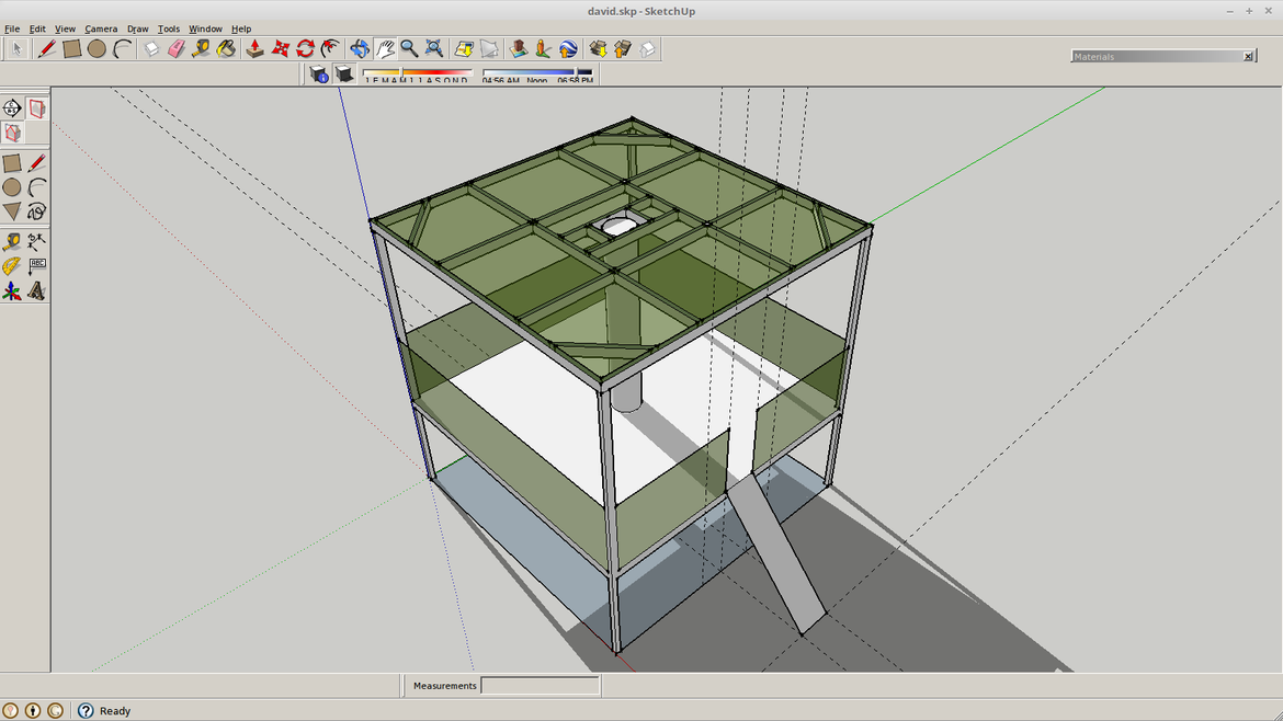

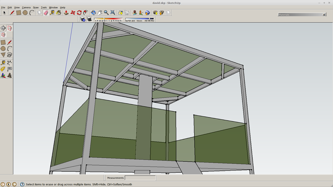

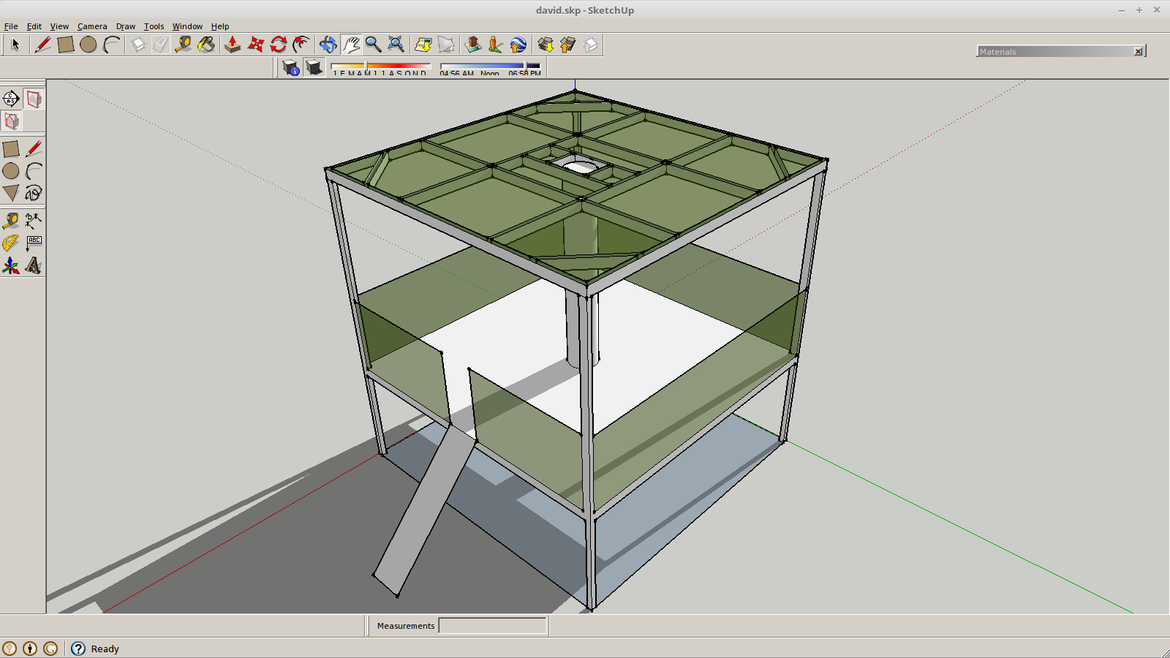

@David61 Here's a couple ideas, sorry just did a quick mock up. With a post or two and the tree as a fixing point, you should be able to get a 3mx3m shade sail up. I'd be inclined to build a small room, it seems you have the skill set for it!
Hello David61, Now that I have seen this photo here are my suggestions.
Heavy duty shade cloth with either 100 or 75 percent UV blocking. ( I'd still put sunscreen on the grand kids )
Shade cloth is weather resistant and lets air go through so you don't die of heat while your under that shade.
Because its UV stable it should last a couple of summers before needing a replacement.
The frame I drew is a suggestion and is not to scale. I drew it with an adult in mind standing in the cubby. However if for the grand kids only then I suggest lowering it.
I was thinking if you want sturdy I suggest spending a bit for the frame and staple the shade cloth to it.
My best suggestion once you build this get the swag tents out and spend the night under the stars in the cubby house.
