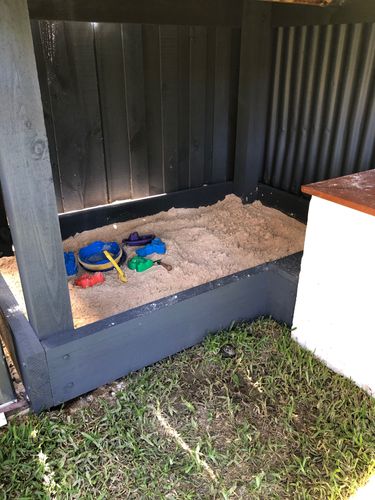

Finished 2.jpgI loved having a cubby house as a kid growing up.  I wanted my kids to have the same fun with a cubby house as I remember, so decided to make it a little project over a couple of weekends.  I wanted to maintain as much space in the backyard as possible.  We had an odd corner between a garden bed and shed so it seemed like a good corner that could be put to better use. (The kids will out grow the cubby eventually and we will remove it).
Posts & Framing
The platform is a four post structure.  I dug footings and used quick setting concrete to hold the posts in place.  I used a combination of bolts and coach screws to secure the pine sleepers to the posts, to create the border for the sandpit and base for the raised platform (depending on whether I had access to thread the nuts given the tight space).
I didn't want to set a post into the lawn if I could help it as it would make it difficult to mow around and would limit the access to the sandpit. I opted for a floating corner and used stronger timbers to compensate for it.
The raised platform is actually floating above the garden bed, maximising the platform space to allow room for the cubby house but minimising the impact it would have on the lawn area below.
Finished Cubby
The cubby itself is a flatpack cubby house from Kmart  - there is plenty of inspiration online in terms of how to dress these up.  I used left over paint we had from painting the house and added a ships bell and blue slide from Bunnings, for some extra fun.
It got the kid's seal of approval.  We've set up a play kitchen and blackboard menu in there for them and they've turned it into their own space, hopefully for years of fun to come.

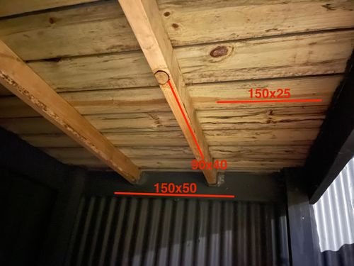

What did you use as the platform floor?

Hi @Kevdou - I used rough sawn treated pine over the joists.... this one from memory
https://www.bunnings.com.au/150-x-25mm-2-4m-rough-sawn-treated-pine_p0120312?gclid=Cj0KCQiAnb79BRDgA...

I'm building something similar at the moment and wondered what you recommend for the upper level frame? I have 140/35 treated pine, but wondered if I should go for something stronger for safety?
Also can you tell Me the height to your upper level?
Re: Kids cubby house with slide & sandpit
Hi @Kevdou - here are the dimensions of the timber I used.
Whilst this is more than strong enough for what I was after, I recommend you do your own research in terms of what is safe / structural for what you're building.
