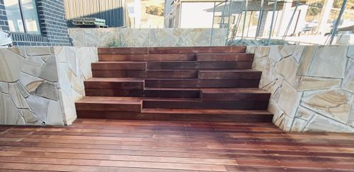

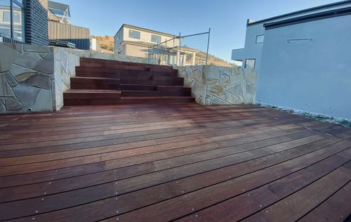

As a newbie and having a first time to experience this kind of DIY job, I would like to ask for assistance in estimating the labor cost for this project. The material cost, including tools, is around $8-9k.
Dimensions:
- Deck: 3.2m (D) x 6.2m (W)
- Staircase: 3.0m (D) x 3.2m (W) x 1.2m (H)
- 8 steps in the middle
- 7 seating places alternately left and right
- 18x 30mm dia. floor-mounted deck lights will be installed soon, together with the roofing.
Main materials are made of:
- 10 sets of 300mm (W) x 300mm (L) x 450mm (H) concrete footings for the deck only
- 500mm (D) x 3000mm (W) x 350mm (H) concrete stair footing
- A total of 47 bags of pre-mixed concrete
- Timber treated pines for deck and stair framing
- Pre-oiled 140mm Merbau decking applied with 1 coat of water-based oil
