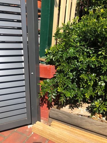

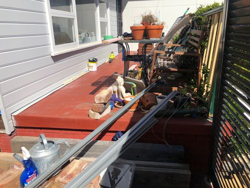

Hi everyone, as the title says I’m looking to extend my front porch; currently have a cement slab on brick approx 6.5x2.1m 550mm high and looking to extend it 1.7m to finish in line with the front of the house and put a veranda over the top and tile. Not sure what the best way to go about it, my thoughts are -
build it as a seperate structure but how do you prep that so you can tile over it
Run a ledger board from the edge of the slab or brickwork and extend as a single structure
or rip the slab out and start fresh, wife not keen on this option and it’s not my idea of fun lol.
I have attached a couple photos for what’s it’s worth, but if a bomb site (mid Reno)
