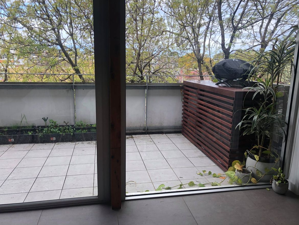

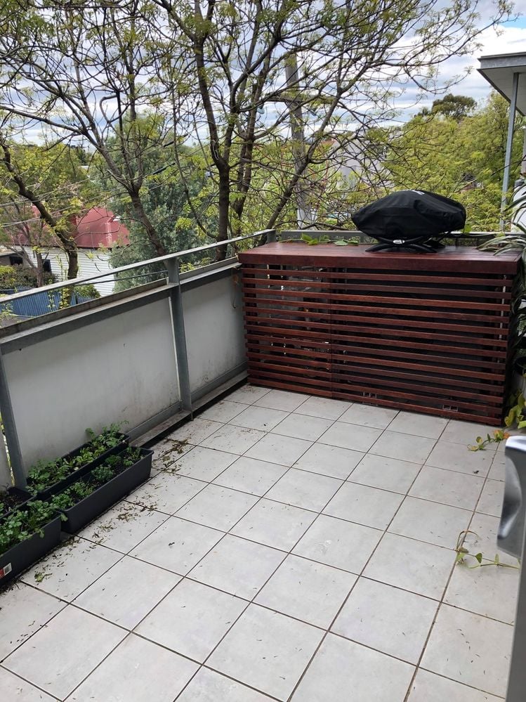

I'll be building this deck directly on top of the existing tiles on my balcony, and do not intend to modify/remove/drill into these tiles. I'd like to keep the total height of the deck <100mm, to avoid creating issues with the height of my existing balcony railing, and the height of my windowsill/doorframe. The BBQ stand/aircon cover pictured below currently finishes 100mm exactly below the height of the railing - this will be placed on top of the deck.

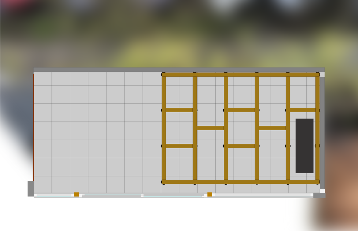

I've mocked up the below floorplan based on my (very fresh) understanding of how the joists should be laid out. I'd love some feedback on this layout and my suggested approach to ensure I'm on the right track.
Images:

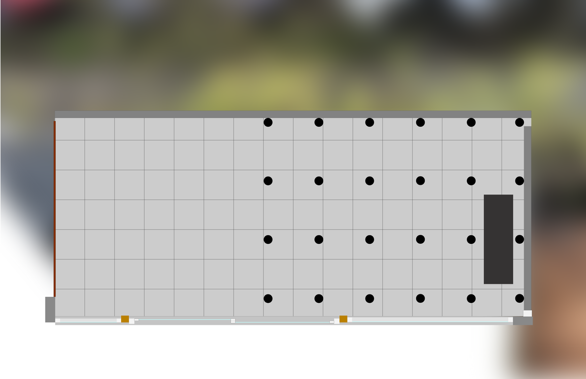

1. Layout of the pedestal feet. The spacing between each joist horizontally is 430mm. The spacing between the feet vertically is 515mm. I know I need to keep the horizontal gaps between joists smaller than 450mm, but do I have too many supports vertically? (is 515mm too small of a gap? Can/should I go bigger, and use less pedestal feet?)

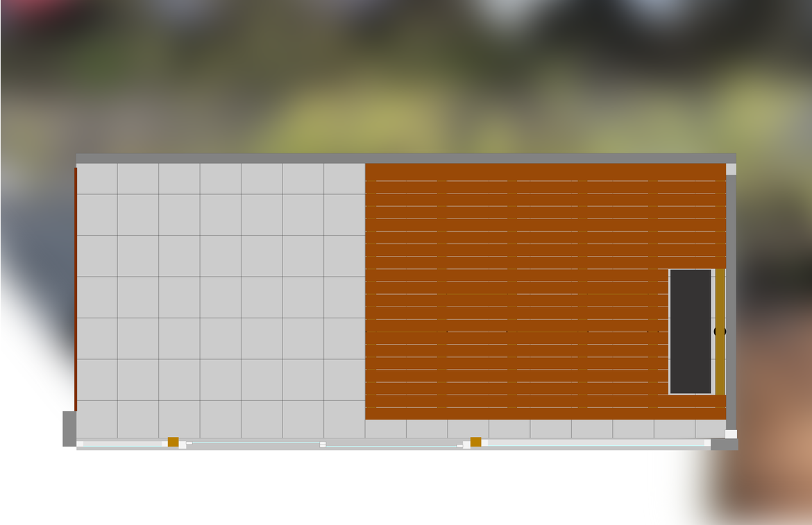

2. Layout of the joists (Feedback appreciated!). Note the deck is built around an existing AC unit.

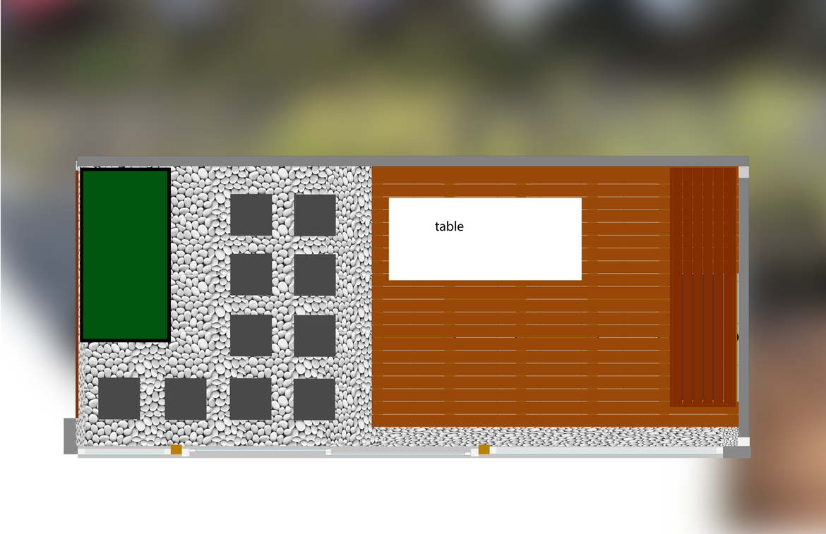

3. Finished deck design. BBQ stand to be placed back in position to hide the aircon.
