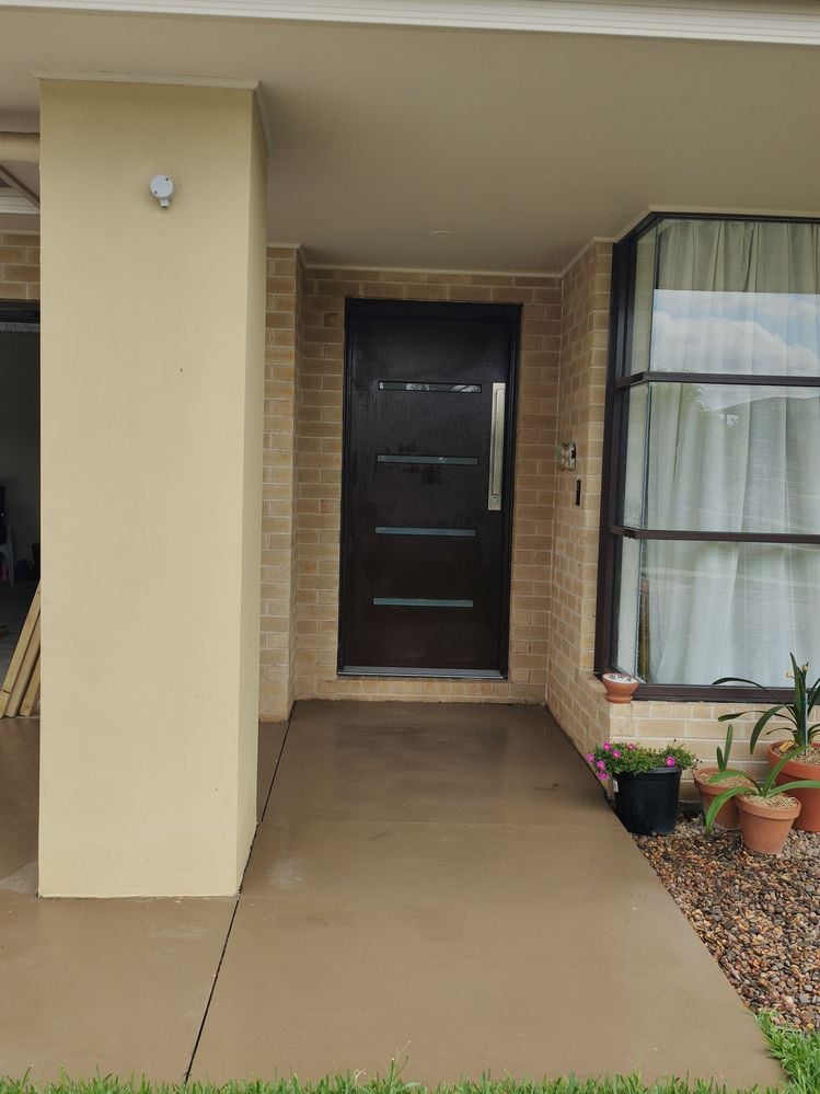

With the confidence and knowledge that I have gained from building my first deck a couple of years ago, I've started building a second deck on my front porch which is currently concreted.

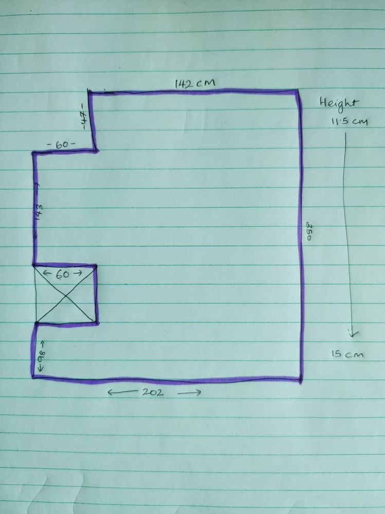

Due to the fall in porch from 11.5 - 15 cm, I had to use framing timber / L brackets of varying sizes.
I am hoping to have a picture frame, however still trying to figure out the best way to go about it due to the unusual shape of the deck. Wondering if someone have any ideas / recommendations that I can draw inspiration from?
I've purchased 1.8 meter decking boards however the deck is 3.5 meter long. I've to lay two boards to reach the total length of the deck and wondering what people do when they are in this situation.
I'm installing joists roughly 45 cm apart however right in the middle of the deck where these 1.8 meter decking boards join, there are no joists. Do you need to have a joist here just so both boards can meet in the middle of the joist? Or two joists for the edge of each these boards, so dust doesn't accumulate here?
Also, the last joist towards outside where I need to attach a facia board would have nut and end of bolt (around 15 mm) sticking out. How do you attach facia boards on to this? screw through 15 mm Plastic space from facia board to joist??

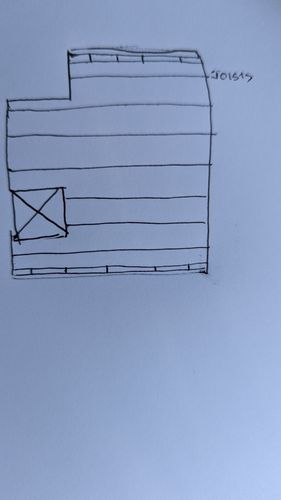

When you said splitting frame into two, did you mean running a board vertically in the middle?
Please find a drawing indicating orientation of joists. Apologies for the crude quality, I didn't really draw a proper decking plan.

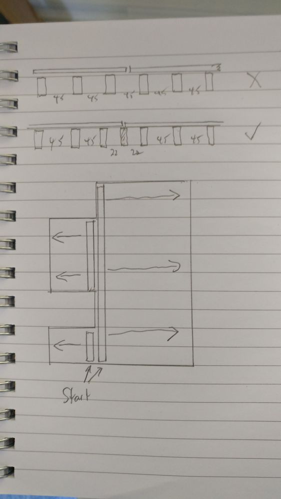

If I understand you correctly, you will need an extra joist to support the ends of the 2 decking boards. For a 45mm width joist there is plenty of room to butt both ends on the single joist. I have made a diagram to show. The only "problem" with this is that you get a single line of joins all the way across the width of the deck and some may find this not pleasing to the eye. If you had purchased longer lengths you could alternate the joins eg 2.4 + 1.1, then lay 1.1 + 2.4 so the joins are at the opposite end of the deck.
You may have already considered this, I have suggested two starting points for laying the decking boards so that there is no cutting required where the deck narrows.

You might have just missed it, but I believe you'll need the double joist and spacer in a couple of other locations for your picture frame. See the image below. I'd imagine you've just left them off, and are well aware of needing them.
