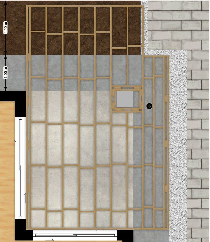

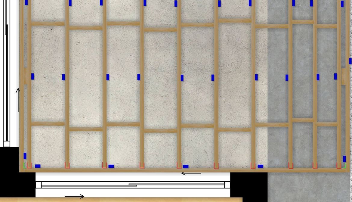

Re: Low Level Deck Advice and Suggestions Pls
Hey @EricL @MitchellMc ,
I drafted a plan for the substructure below.  Do you think this would work/be strong enough? I just based this off what I have read about low level decking discussions on this site.
The red bits are the joist hangers, blue bits are the angle brackets, and green ones are angle brackets to connect the corners. I also plan to put shims as spacers between the joists that are against the walls.
