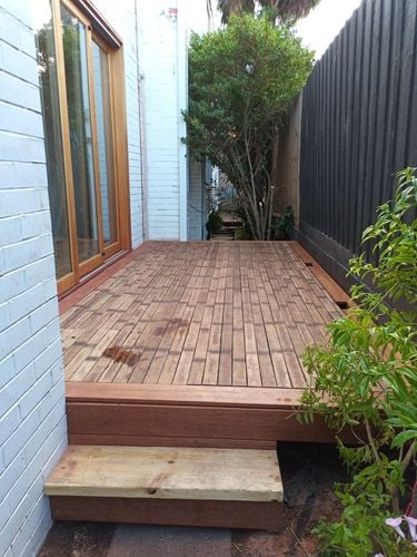

Deck build went great!
- 250-400mm high (ground is on a slope)
- Size is 4600 x 2270mm
- Earth underneath
- both 4600mm sides are concrete/brick walls

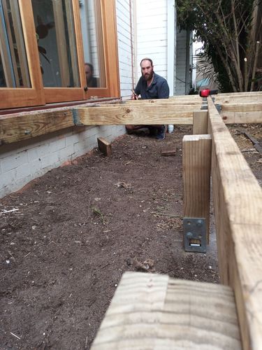

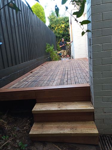

Dynabolted ledgers onto either wall. Used brackets bolted into pre-existing pavers to support the posts down the centre. New 120mm merbau for the trims, reclaimed merbau for the main deck space. Steps took a bit of figuring but turned out great.
