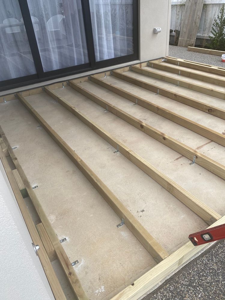

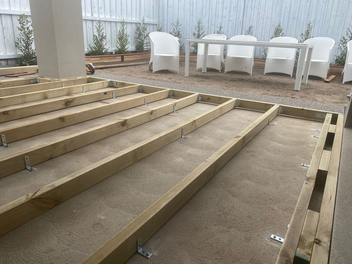

Thanks for your reply. I did go for 90X45 in the end precisely for the reasons you mentioned above. Hence my final deck height is just above 110mm.
Timber arrived today and will commence work shortly. My next post should provide photos of work in progress.

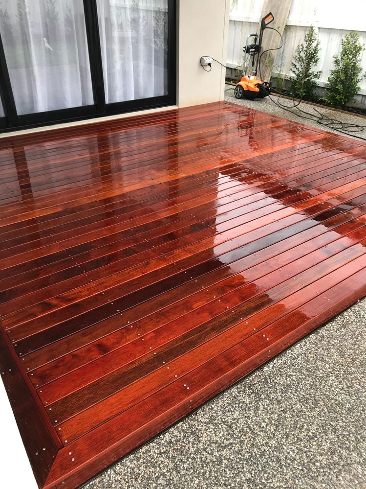

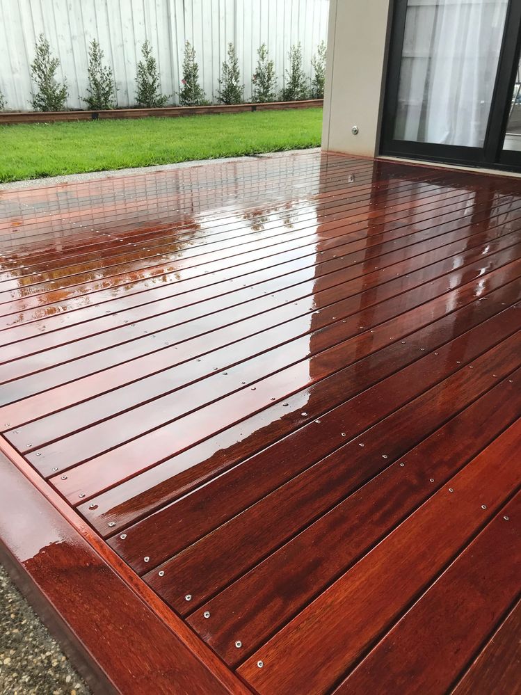

@MitchellMc Few photos of the project.... tad late but finally here...

Spectacular outcome @Backyardtradie!
I trust you are really proud of your efforts, and rightly so. Your project will be of great inspiration to others that wish to give something like this a go.
Well done and many thanks for sharing your results.

Thanks so much for sharing those photos of the completed deck @Backyardtradie. It looks fantastic. Congratulations. I'm sure you will enjoy many special times on that deck with your family and friends in the years to come. I have featured the deck on our Project Gallery as your handiwork is bound to inspire others.
