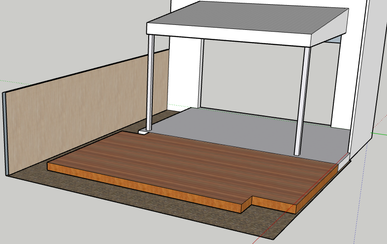

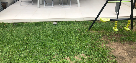

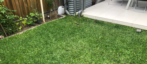

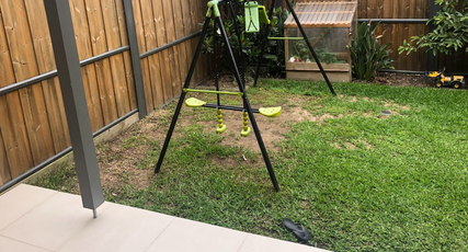

The deck I want to build will go over the existing lawn shown in the below photos. Decking surface will be a continuation of the existing patio tiled floor.
Hopefully the below images show the transformation I am expecting to achieve!
The ground height below the patio surface ranges between 140mm to 200mm. With the small depth available, I thought of building the deck with 19mm thick decking boards laid over a 90mm deep frame supported on steel stirrup posts.

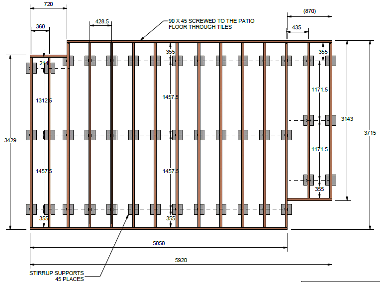

90 x 45 MGP10 H3 treated pine is what I am thinking of for the construction of the frame.
I have two ideas for the frame as shown below. Whilst Frame 1 may be more economical I think Frame 2 would be easier to build with the lower number of stirrup holes that need to be dug in the small backyard.
Frame 1
Frame 2
I would much appreciate it if you could let me know your thoughts on which approach is more sensible and structurally sound 🙂
