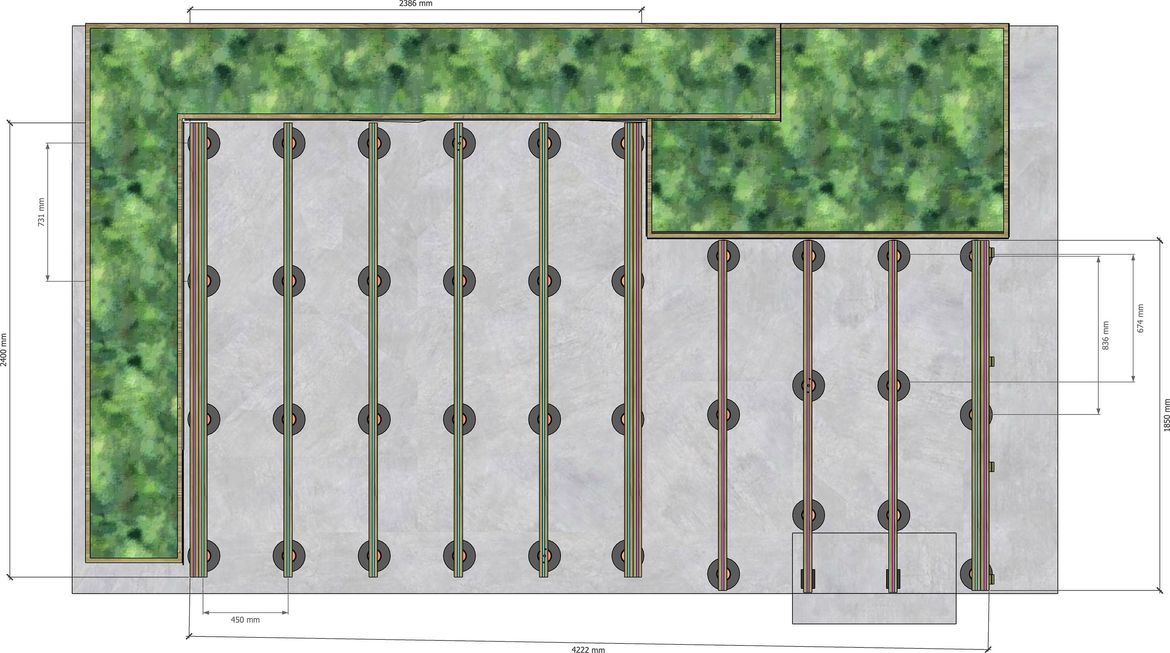

I'm building a low deck over concrete. I've done up my sub-structure plan (option A), but i'm wondering if I've over-engineered, and could get away with less builders feet (option B).
Or maybe i've missed something entirely!! Would appreciate feedback.
using a combo of 90x45 (blue) and 70x45 (purple).
option Aoption Aoption Boption B

Thank you so much for sharing your decking frame plans. I suggest going with option B as it will still be providing adequate support despite less feet. My only other recommendation is to add noggins between the joists to firm up the assembly.

thanks @EricL , I'll add in some noggins, and go ahead with option B!  And I will remember to take lots of photos of the process.
