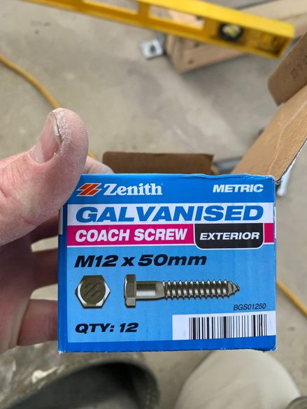

I’m going to be building a low deck on this concrete slab so bearers and joists same level. It measures approx. 5160 x 4260. I have approx. 150mm from concrete to top of deck to fall in line with sliding door frame
I’m thinking of using:
Galvanised brackets
90 x 45mm H3 pine so I’ve got room for adjustment and levelling
into concrete
M10/M8  75mm coach screws bracket to joists/ bearers
I will be running the decking long ways (Specrite Merbau Decking)

My question is, is this doable with the products I’m using and also how should I strengthen the frame? Spacings? Doubling up bearers/ joists etc?
The table will be sitting in the middle of the deck so will I have only strengthen this area only?
