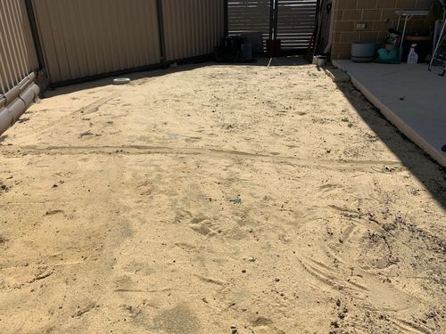

Hi everyone. New to the website. Looking to build a deck at the girlfriends house. Any advice on ticking all the boxes would be really appreciated.

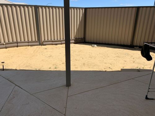

First issue I face is the lack of clearance under the deck, is this something I can resolve using H4 timber. I’ll will have to dig out and remove some sand. Is there a minimum gap that is required underneath the frame?
This is what I’ve got planned so far.
Size of deck 4.8x2.6m
Bearers 140x45mm @ 1300mm centres (should I go double bearers?)
Flush joists 140x45mm @ 400mm centres using joist hangers.
Thinking of using stirrups though unsure on the spacing.
At this stage thinking of building and installing the frame in two modular section of 2300x1400mm.
Pretty new on the DIY game so any advice would be great.
