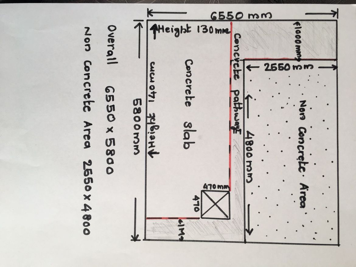

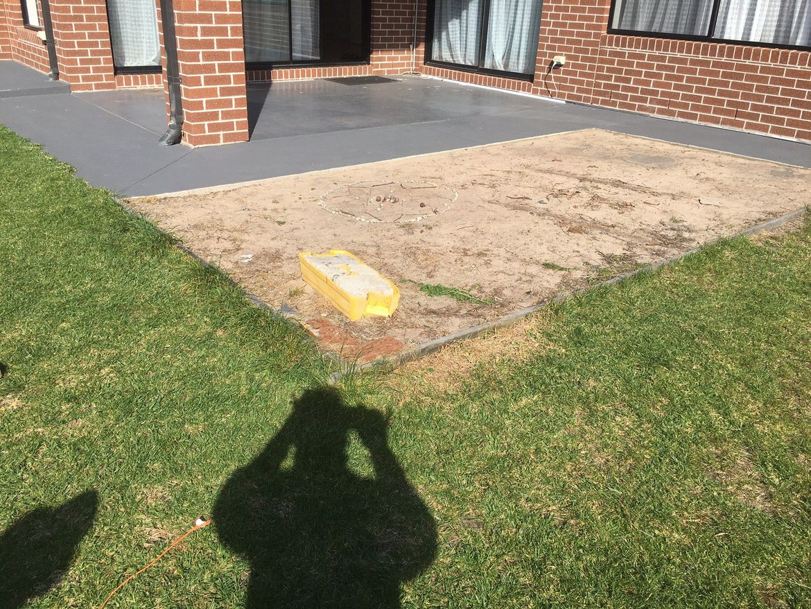

I am looking to start building a low-level deck, some part covered and some part open deck (6550*5800) and need someone to help with my questions below. The deck meets the house on two sides, one being 130mm clearance and the other 140mm.
1. @MitchellMc can you please help with some basic drawings based on the above deck dimensions?
2. What kind of joists I need ? H4 90 x 45?
3. What kind of bearers I need same as joists above?
4. What will I do in non concrete area? Is Tuffblock a good idea? Any other suggestions pls.
5. What height I have to achieve? (130mm?)
6. I am doing a picture frame deck 140x19mm Merabu as a frame and in the middle portion. Then rest is 90x19 Merabu. Pls see Pic attached.
I have more questions to ask. But for a start please help with the above questions will be great.
Cheers
