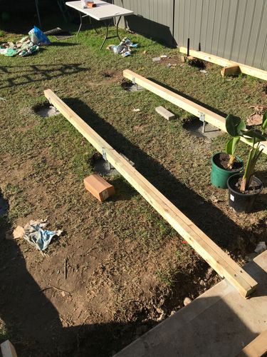

Hi @Johnny
Thanks for the photo
Try attaching Stirrups direcly to the Bearers
cast into Concrete   pad hth

@BIM_Engineer thanks for the advice, much appreciated. As I haven’t done any concreting like this before can I go one further and ask the approx depth and width of the pad? Also, the positioning of this particular stump as you can see from the pic will be where the pool used to be until recently. The soul was compacted but I’m wondering if a deeper hole/concrete will be needed for the bearer support pad as soil may not be as firm due to only recently being put in?
Also, what is the best concrete to use as the pad?
sorry, hopefully that all makes sense

@Johnny
Notes to pad footings sketch
250-300 Diam Depth generally
Those brackets connections can be offset to the bearers
The soil needs to be compact beneath the footings or dug into natural soil
..dig the footings a little deeper
Get the ready mixed bags of concrete...just add water and mix
Check Out The Videos here
DIY Decking for tips..hth

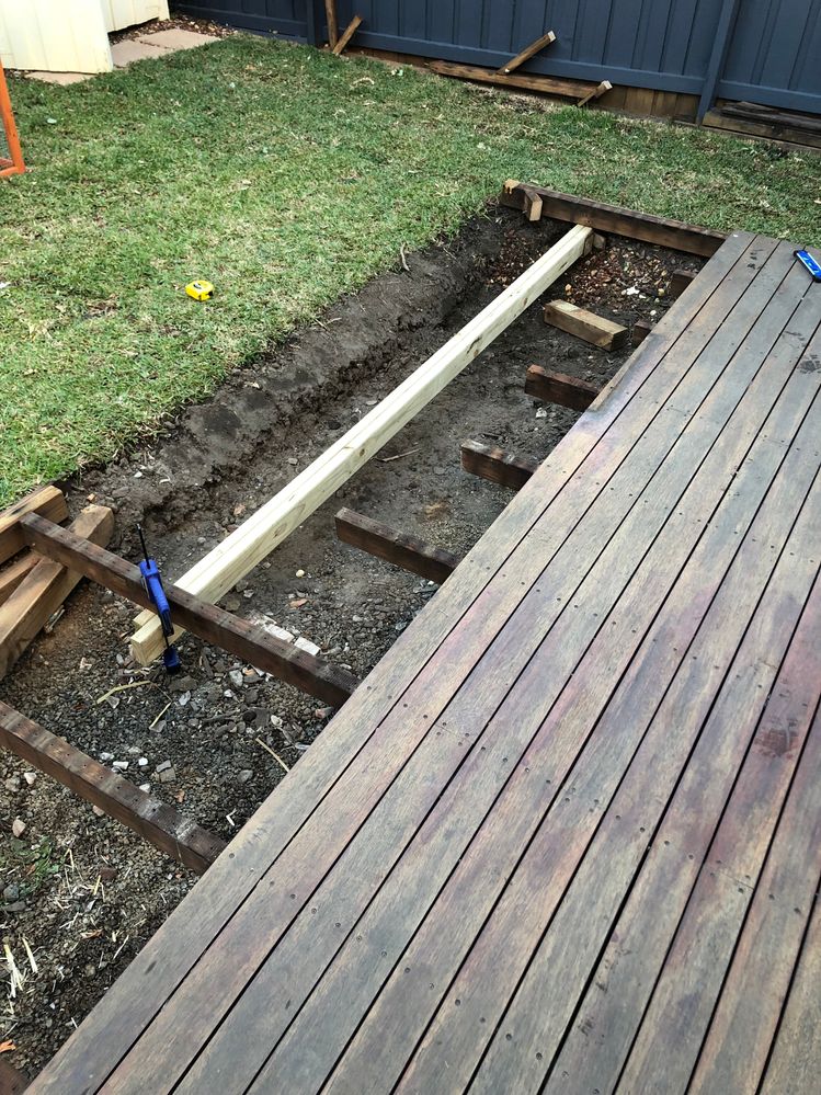

 So this is where I’m at on the deck. Im just wondering if having this as the last bearer is ok, and let the joists overhang by approx 500mm? TIA

@johhny
Place the bearer roughly in the same location as it was previously
from the end.( Cantilever Should be less than 10% of the back span)
Bolt( 2-M12 /joist) the extension joists over the bearer.hth
