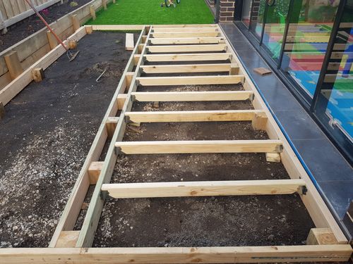

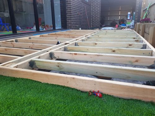

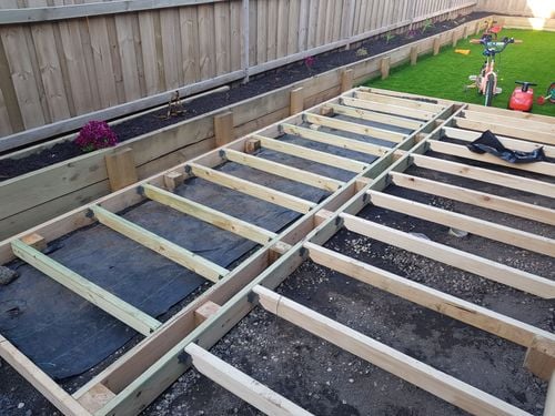

I just finished frames (all H3 treated pine) for my deck today (5.2m x 2.7m).
After reading a few posts on low level decks in this group, I am really worried for 2 reasons:
1. I have only 1 off 140x45 bearers, and not 2 off them screwed together as advised in some other posts here. My posts are placed 1300 apart. Posts are 100x100s 350 to 400 deep. Joist are all 90x45s.
2. What worries me more is that my bearer are sitting very close to the ground, it is touching the ground in some location. How can I waterproof it?
Community manager's note: Check out How to build a low-level deck for expert advice.
I have attached some pictures if that helps.
The height of the decking currently was druven by the nayural ground and level of the house. Now I understand i should have dug and removed some dirt. Too late for that now, I guess 🙁
Any suggestions will be really helpful.
P.S: do I need to put timber between joists and connect them to prevent warping?
