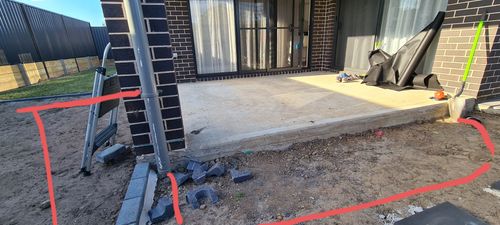

Hi guys,
Just looking for some advice on how to go about building a low level deck off my existing alfresco.
Area is 4x3.2 at the moment but we are looking to extend it to 6x4m. One issue Im worried about is the height between the concrete and the sliding door which is 70mm
Would appreciate some instructions plans and materials needed if possible.

Hello @spongebob2173
Thanks for sharing your question about low-level decking over a concrete extension. If for example, you used Treated Pine Outdoor Timber Framing 90 x 45mm and turned it with 90mm end facing up. You then add the thickness of the decking panel itself. If you use Ekodeck it would have a thickness of 23mm. So 45mm plus 23mm equals 68mm. This would leave you an air gap of 2mm. Ideally, you would want more, if rain or moisture were to enter the area it will greatly shorten the life of your deck.
Let's say for example you used timber decking panels instead. It would be 45mm plus 19mm which would equal 64mm. You would then have a 6mm air gap. In order to line it up with your sliding door, you would need shims to lift the frame and use angle brackets to hold it in place.
