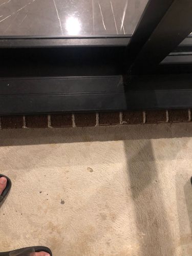

Any tips on how to fill the gap where the raised brick area is. If my joists ends at the brickwork and the merbau sits on top until where the brickwork starts. There will be a small gap left between the door sills and the merbau. My deck will be at level with the floor. And the gap hieght ( from top of brick work to floor hieght)
is 60 mm .
