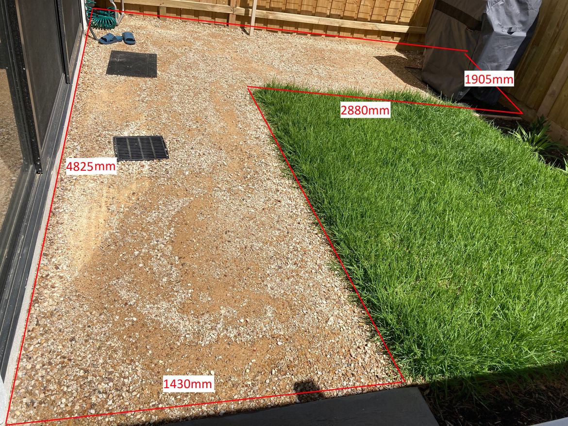

Hi all, I'm planning to build a deck soon and was wondering if someone can help to calculate materials required and if possible share their experience. I was planning to split it into two parts initially but then decided to build it as a single platform. I am planning to use spotted gum STD BTR 64x19mm if I find the supplier or 86x19mm from Bunnings. Base frame will most likely be 70x45mm on concrete foundation blocks. Please see the image below with dimensions. Thanks, VS

I'd encourage you to start by reading through @Adam_W's guide on How to build a low-level deck. Then you can start planning out your deck and how you would like to construct it. This includes which way you would like the decking to run, if you will be picture framing it and the height at which you wish the deck to be. Below I've put together a diagram to illustrate how your joists could be set out. You'll be nailing your boards onto the joists and their centres need to be roughly 450-600mm apart. If you search for low-level deck in the community you'll find tonnes of helpful discussions of members that have successfully built their own deck.
For calculating your decking material you should find this Specrite decking calculator handy. If you were interested in the 64 x 19mm Spotted Gum then a helpful team member at your local store's Special Orders desk would be more than happy to enquire with our decking supplier for you.
