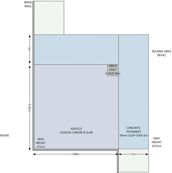

I am planning to build a timber (Merbau 90x19mm) deck in my alfresco area. Deck will be over levelled concrete slab (which is part of the house slab) plus concrete pavement. Maximum height I can get near the house is 9.5cm as I cannot cover weep hole in the wall.
Main issue I am having is the concrete pavement since it has 70cm slop over 1m.

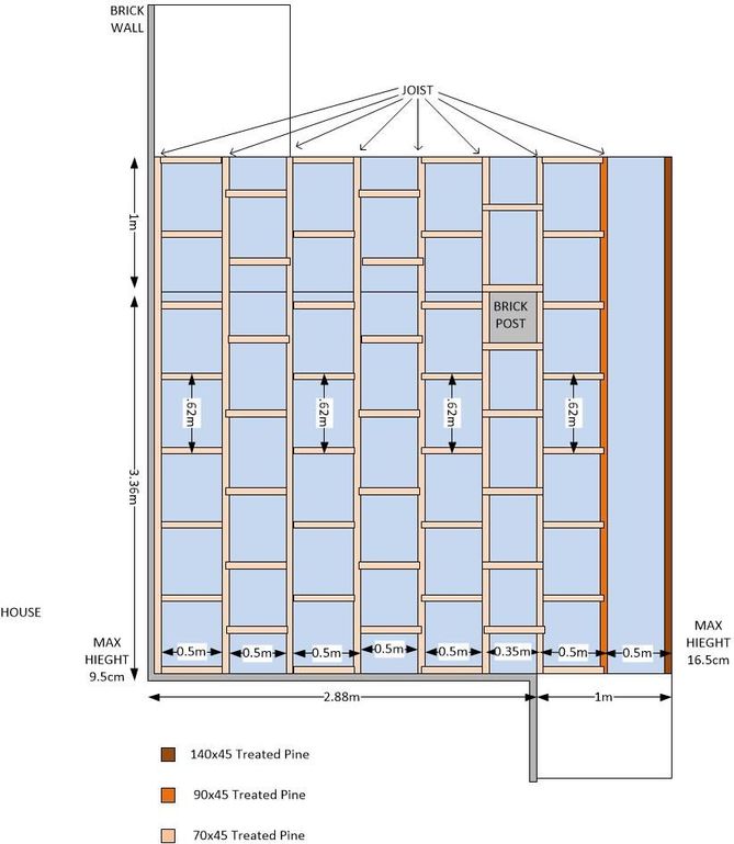

Proposed Structure:
Joist: 70x45mm Treated Pine in the slab area , 90x 45mm & 140x 45mm Treated Pine in pavement as shown below.
Cross section:
I am planning anchor timber joist to the slab using "L" shape plates. But, not sure what will be the best way to mount the timber in pavement area.
Can you please give your valuable thoughts/ comments on my proposal & a solution to mount the timber joist in the pavement area?
