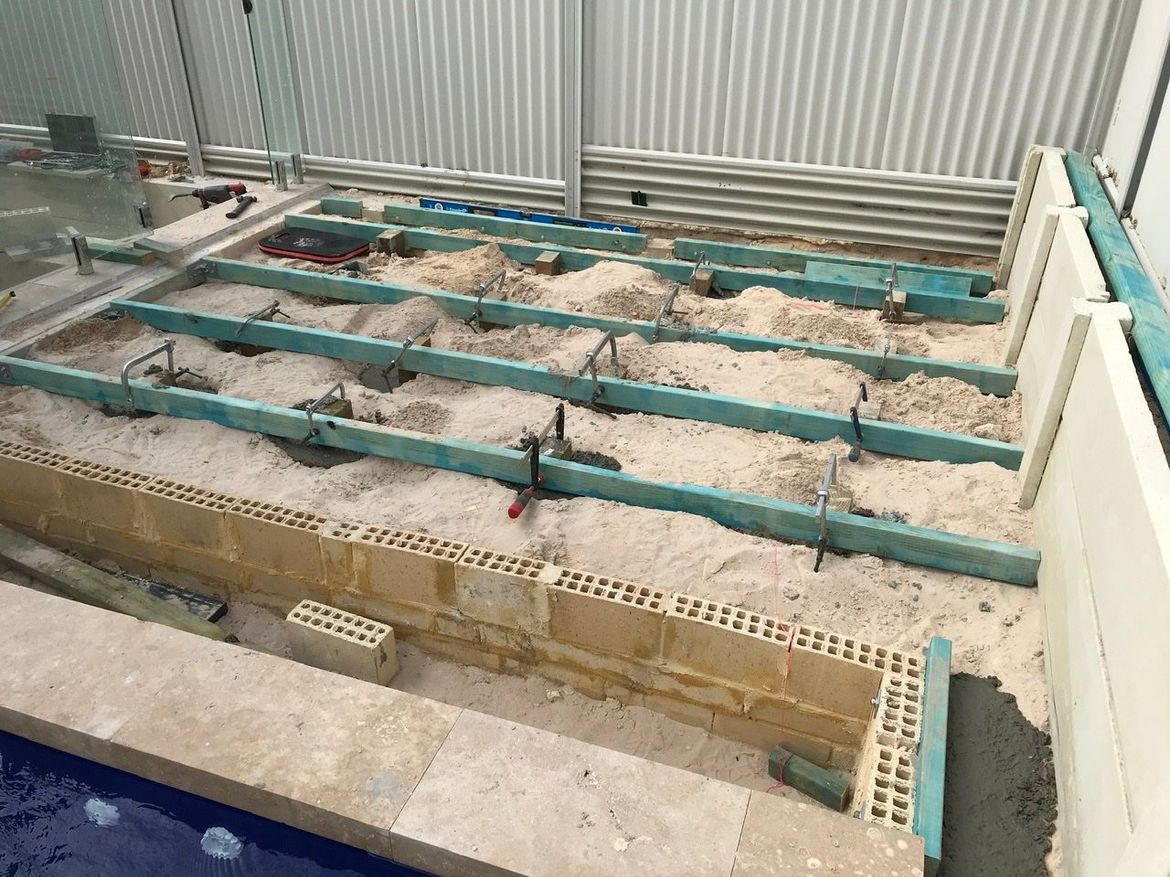

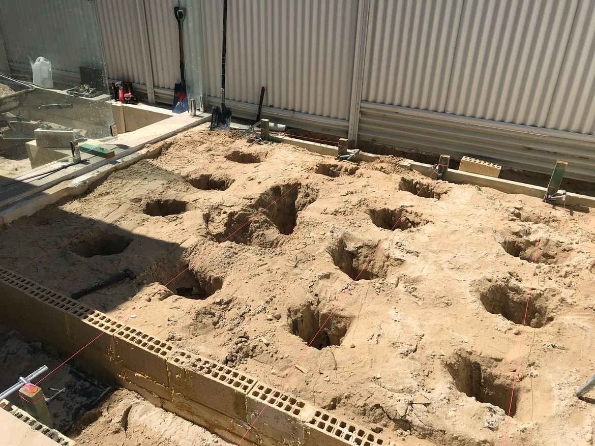

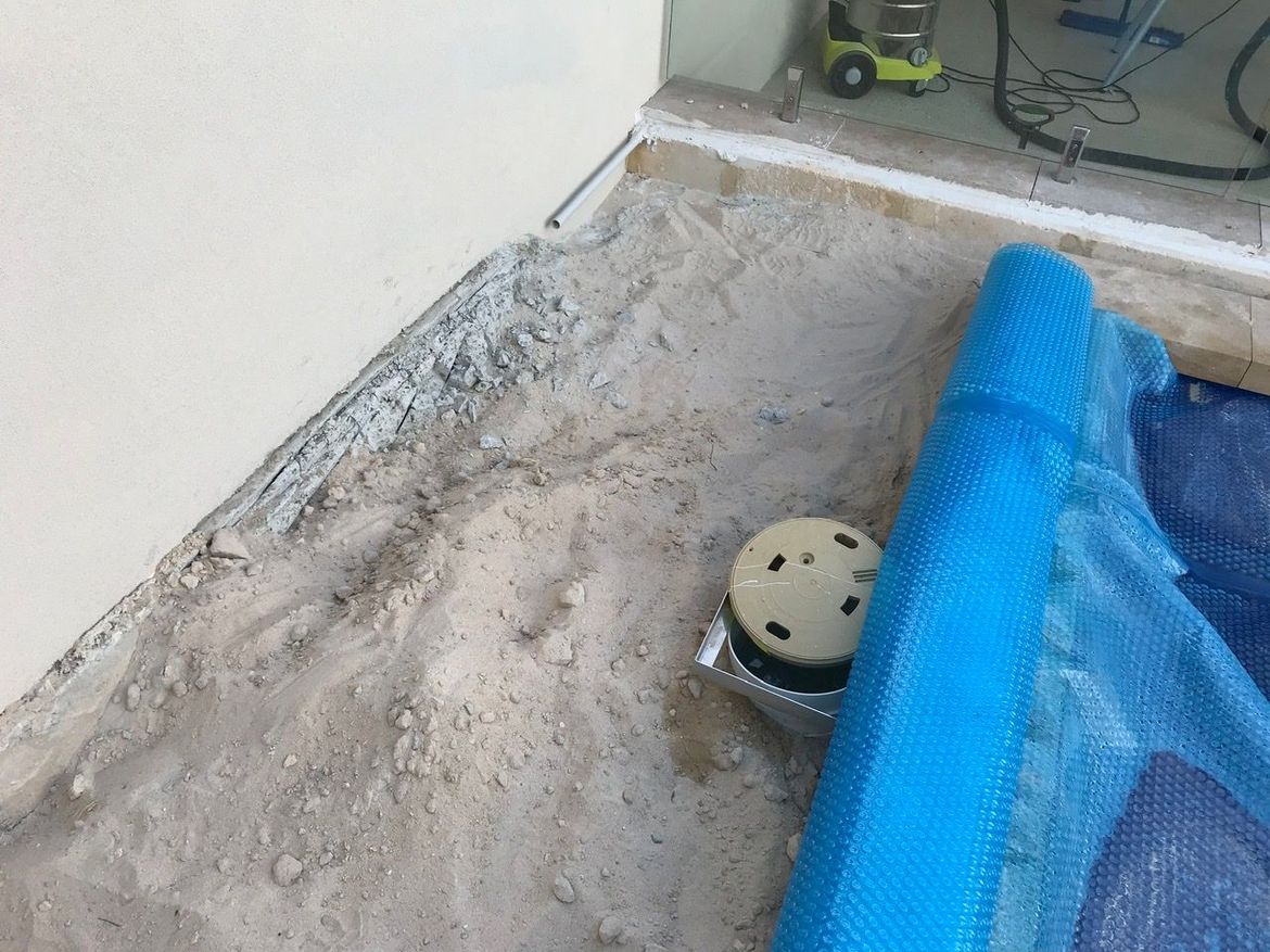

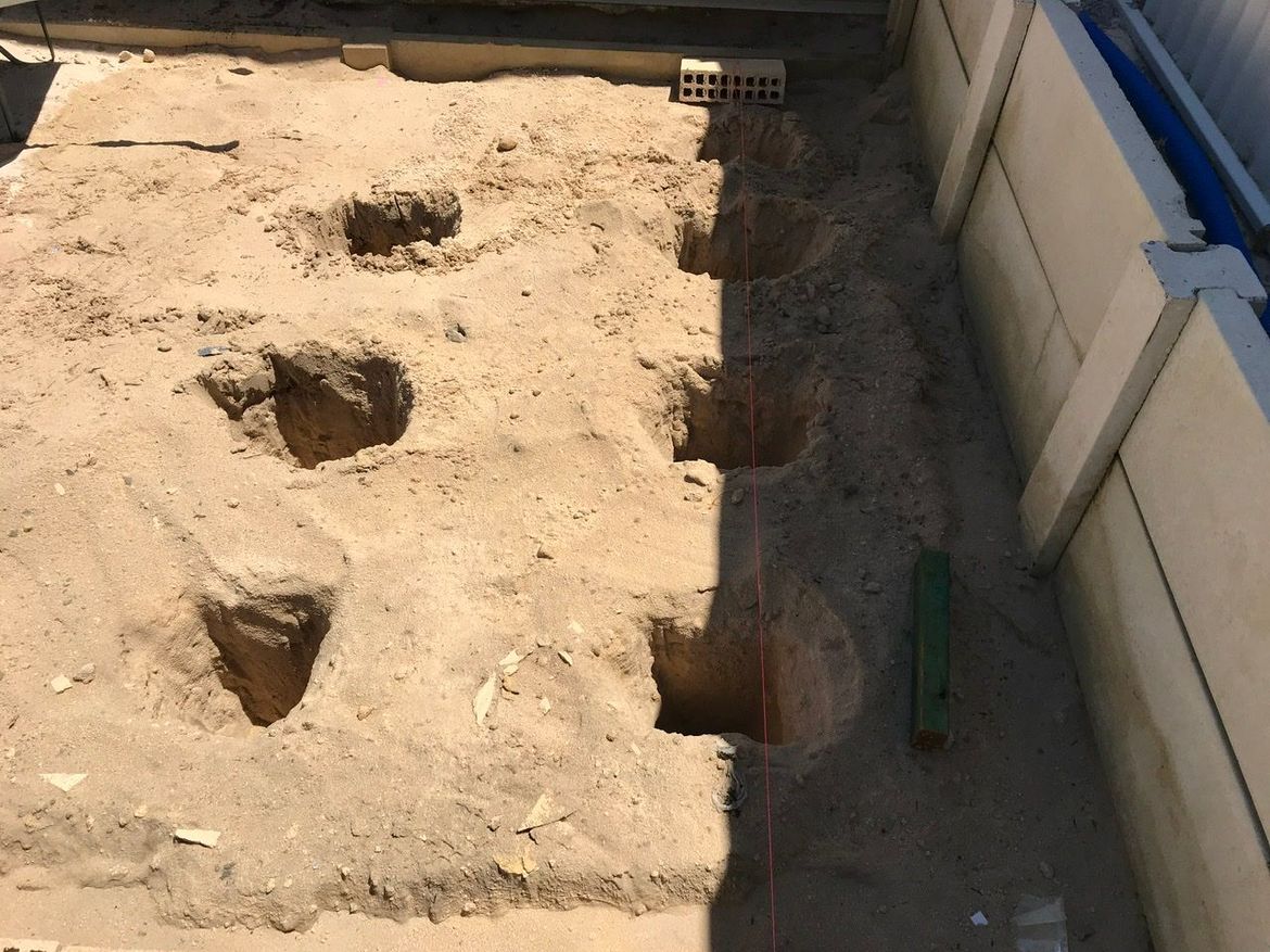

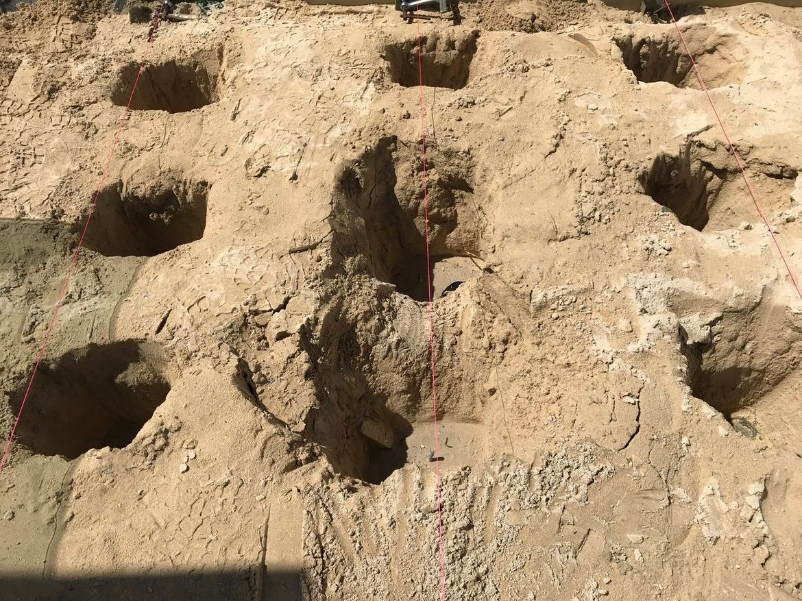

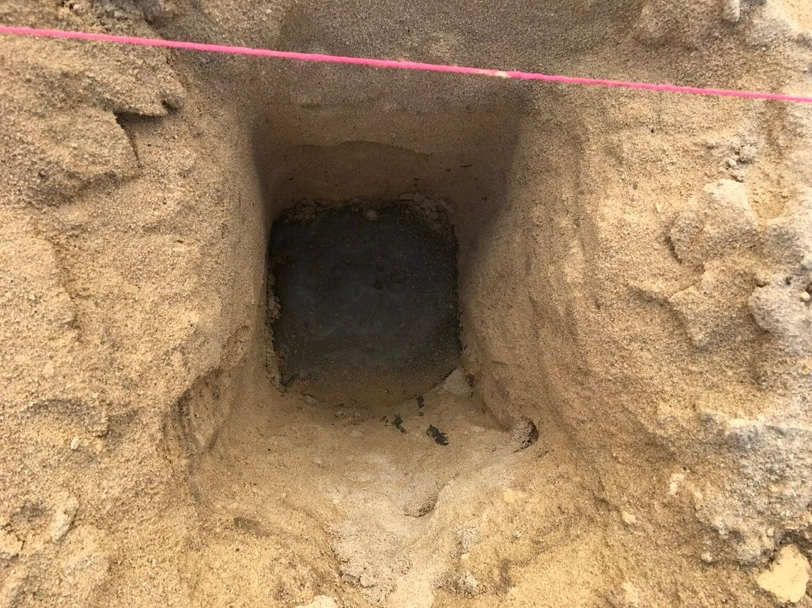

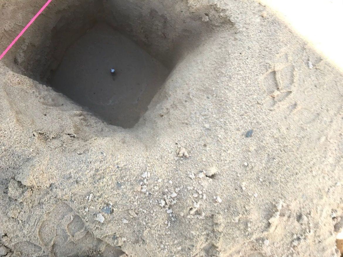

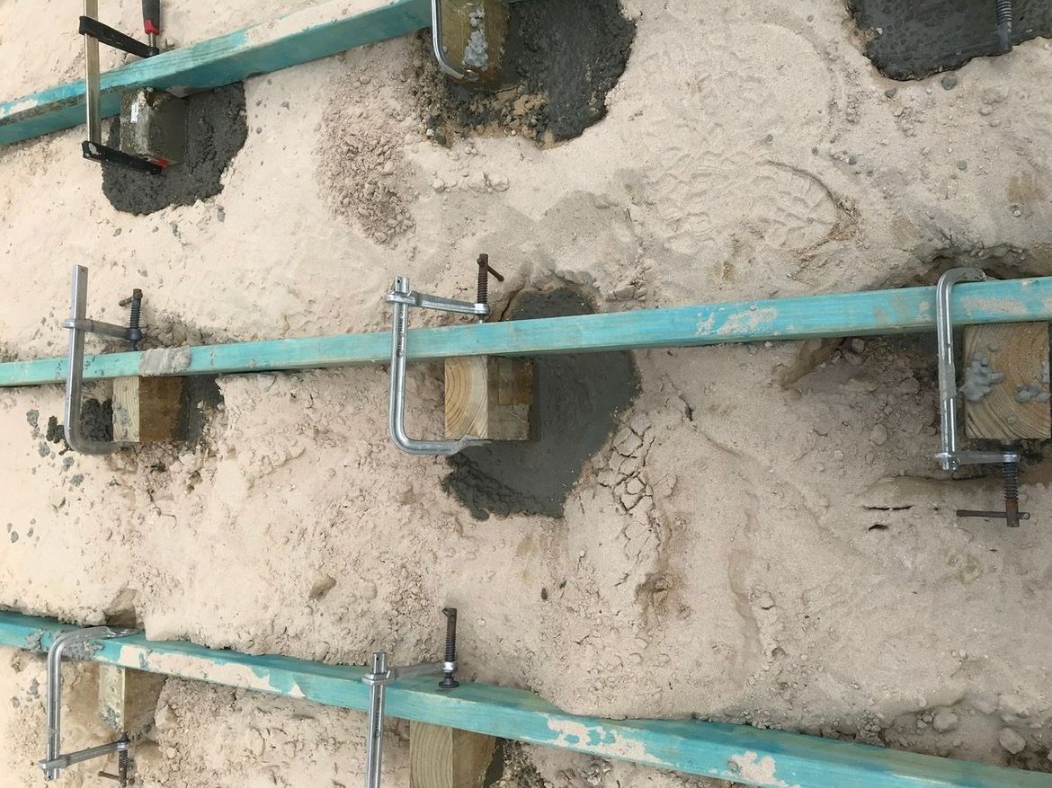

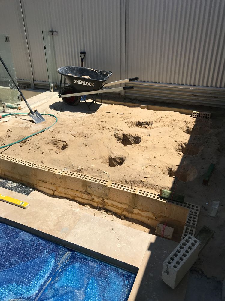

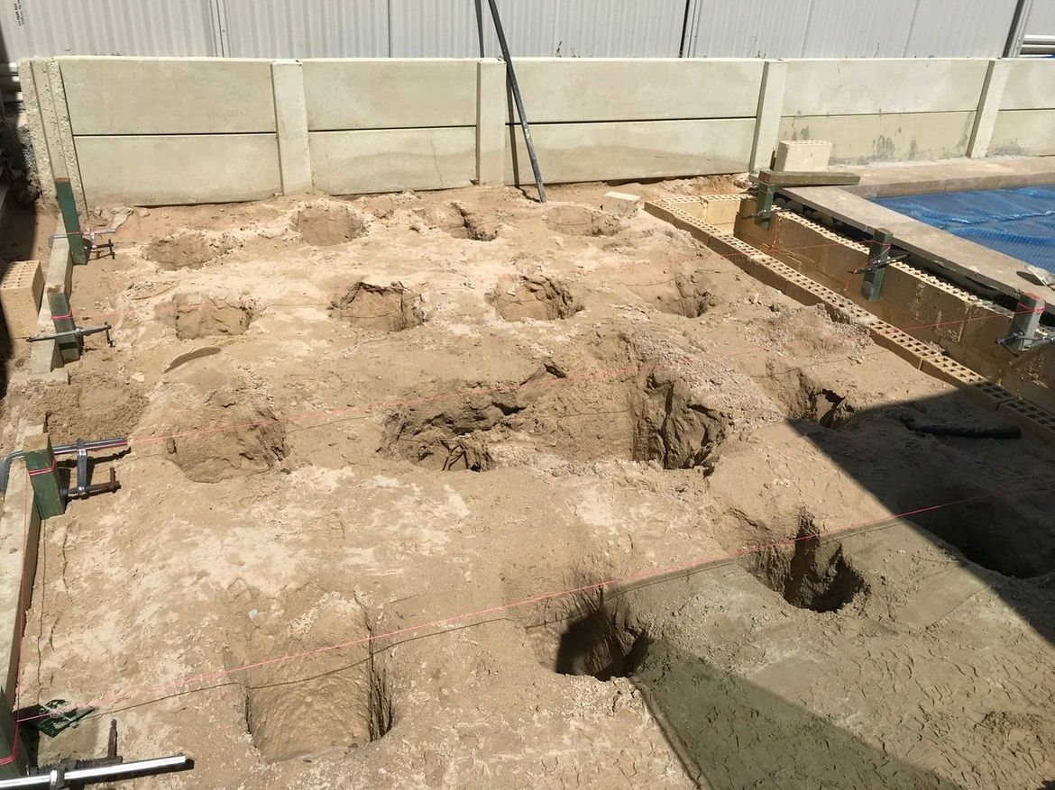

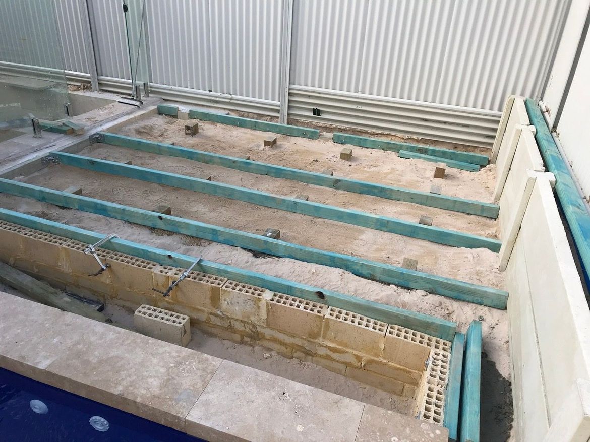

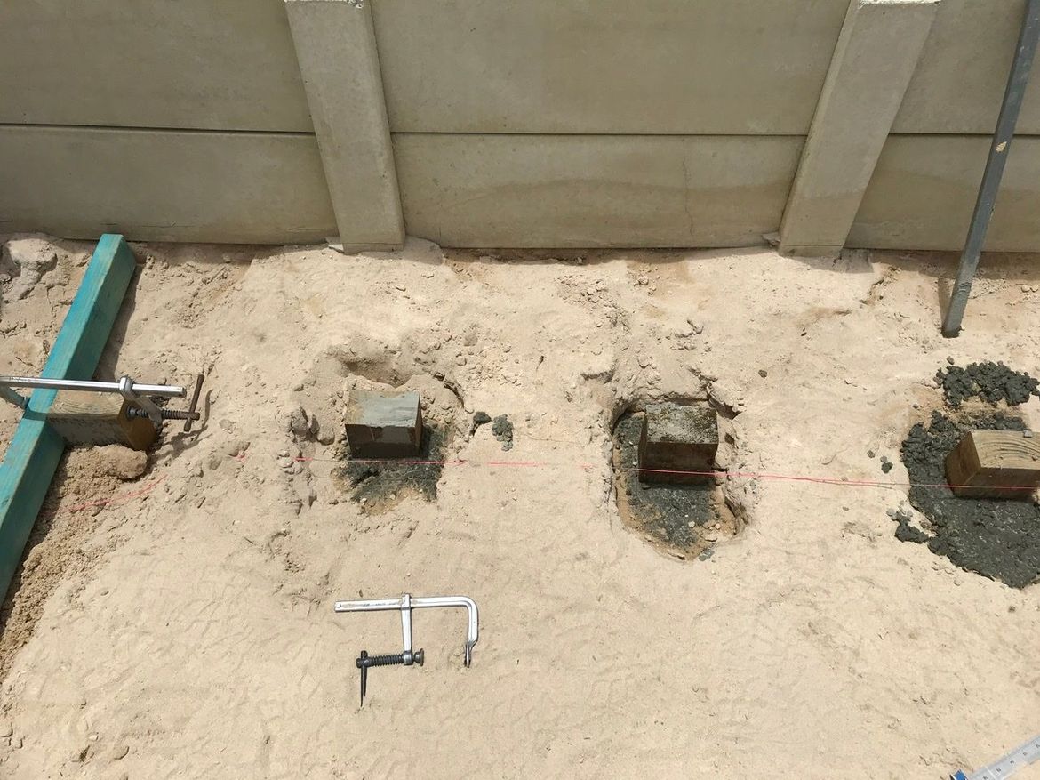

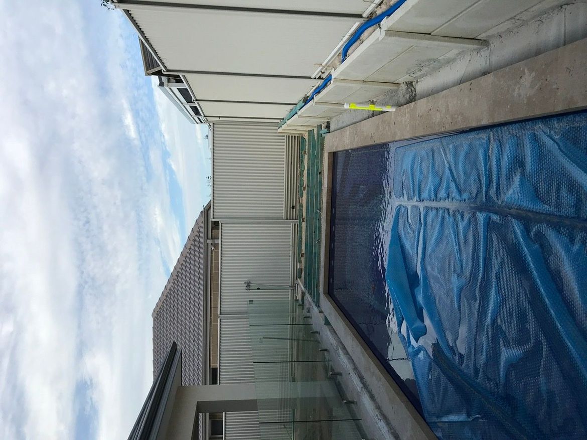

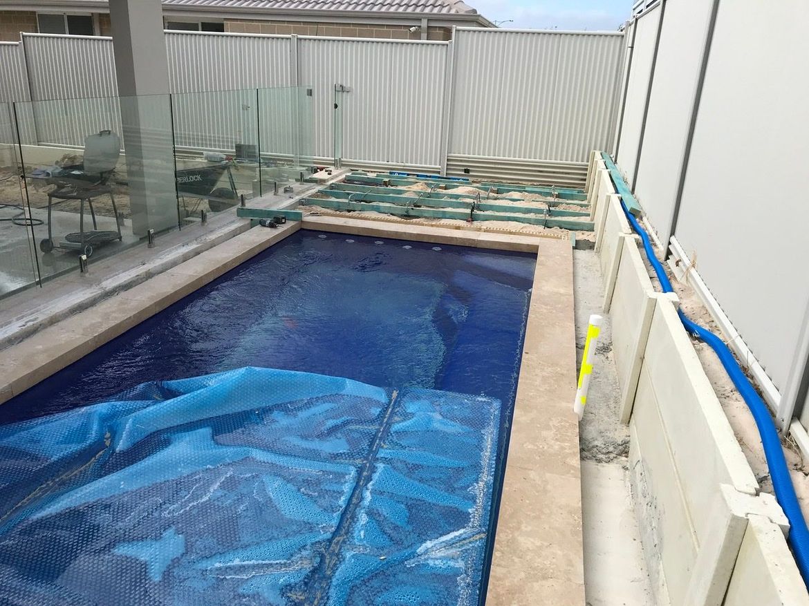

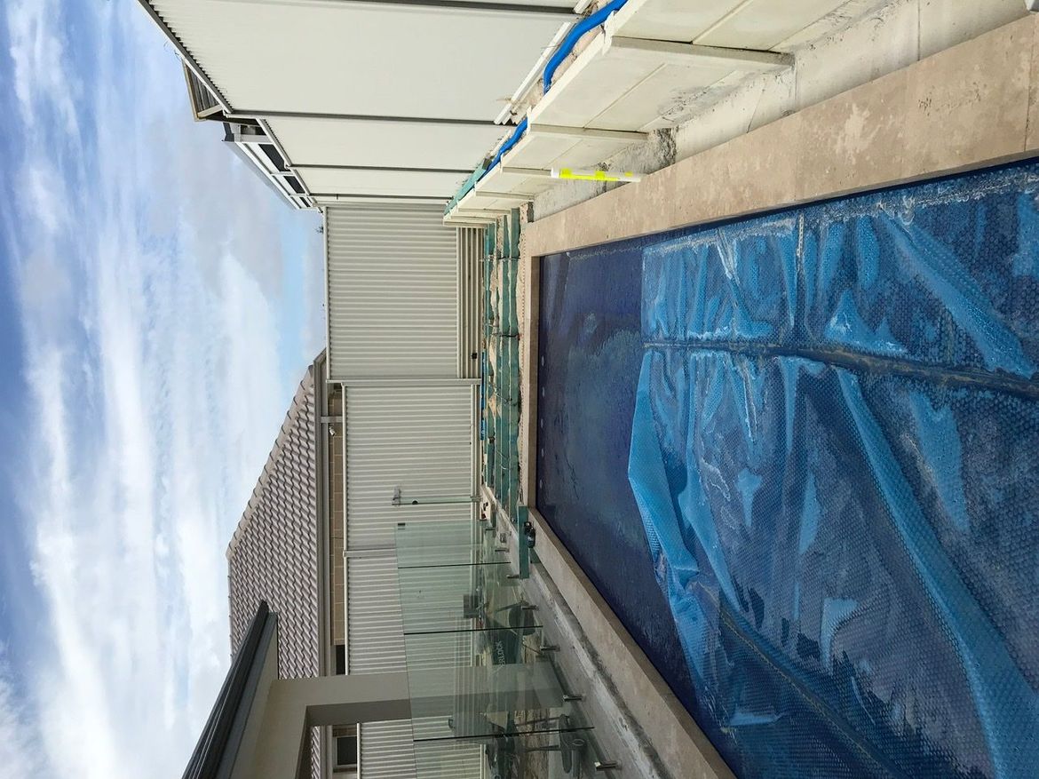

So, bear with me, ill update as I progress,

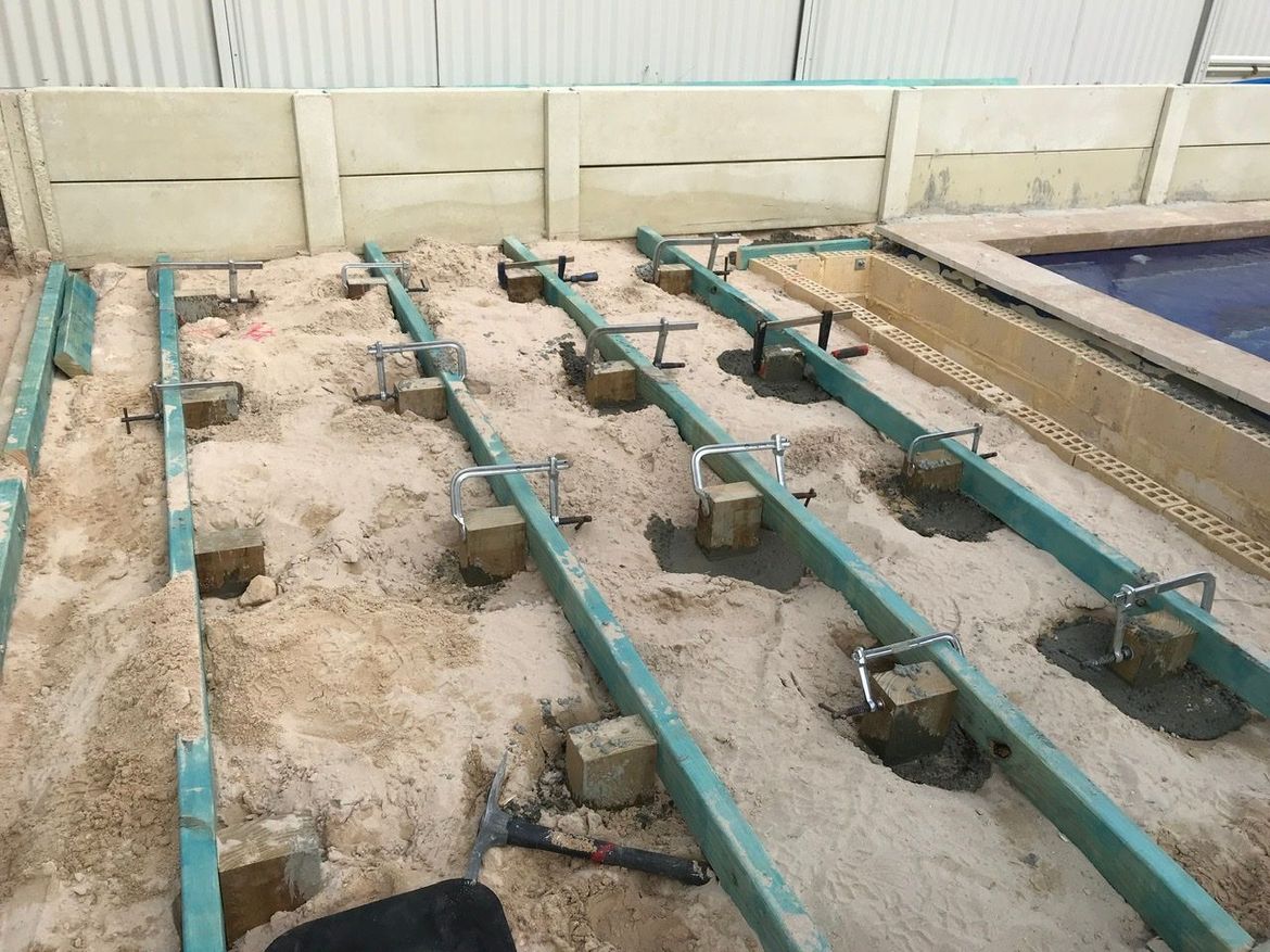

we have just built a house in Western Australia, pool went in before the house. I have already done the glass pool fence, now I’m moving onto the pool area surrounds.
We tossed and turned with the ideas, deck, paving, grass, eventually settled on decking. Personally I hate composite decks. They look plastic and when I measured the temperatures on some surfaces at the pool display area last summer with a infrared heatgun, the ekodeck was about 8 - 10°c warmer than jarrah or merbau.

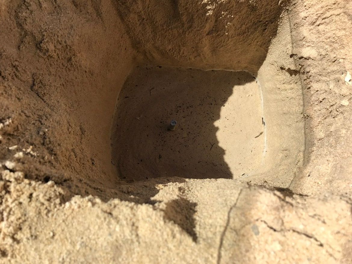

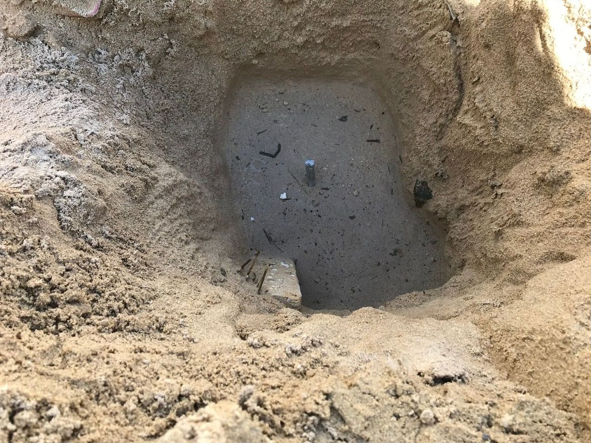

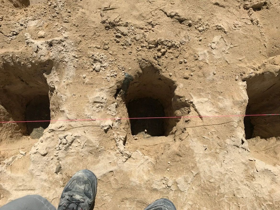

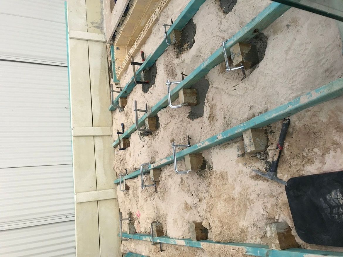

so we are going for merbau. It’s a low profile deck, minimal ground clearance. I probably went a bit overboard on the ground posts and beams, but rather over engineer than under engineer. Also, I don’t want a “springy” or spongy deck. So I decided to double the joists as per the span tables but space them 75mm apart.General Pool AreaGeneral Pool AreaUnderground Pool Cover BoxUnderground Pool Cover Box

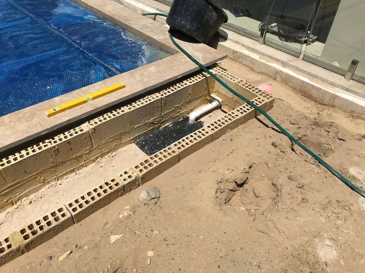

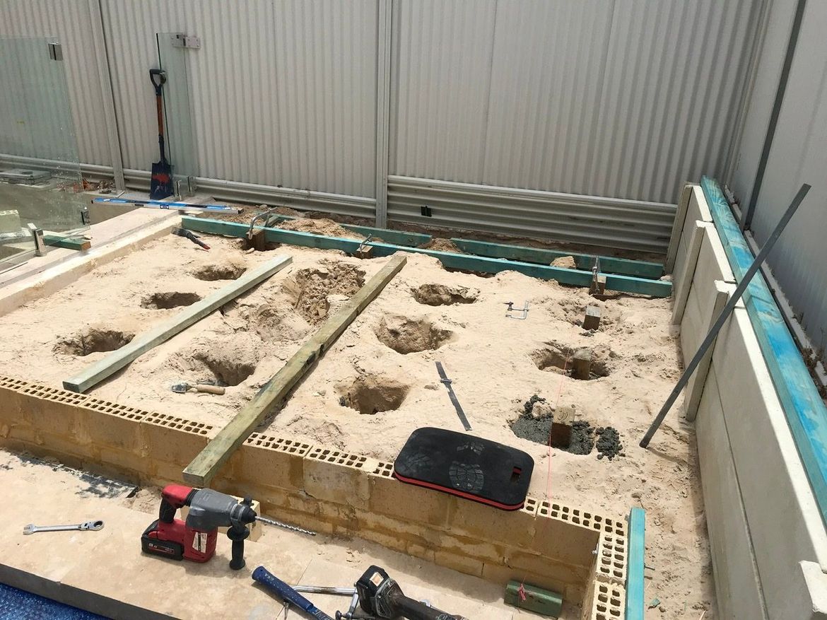

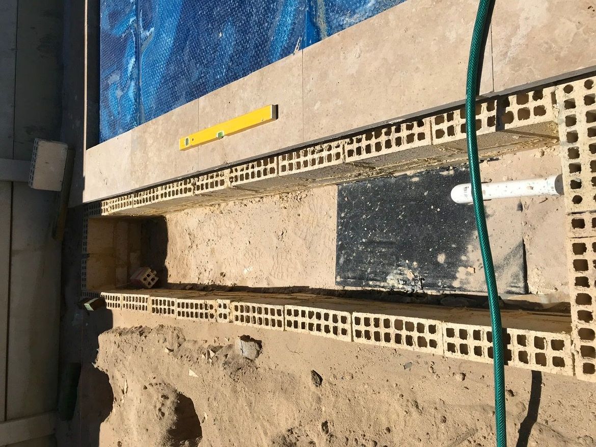

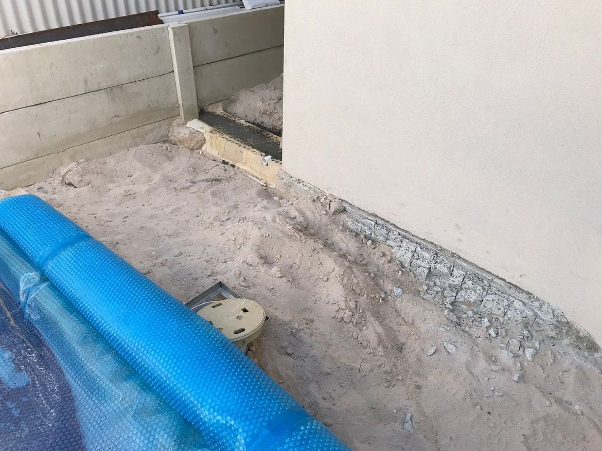

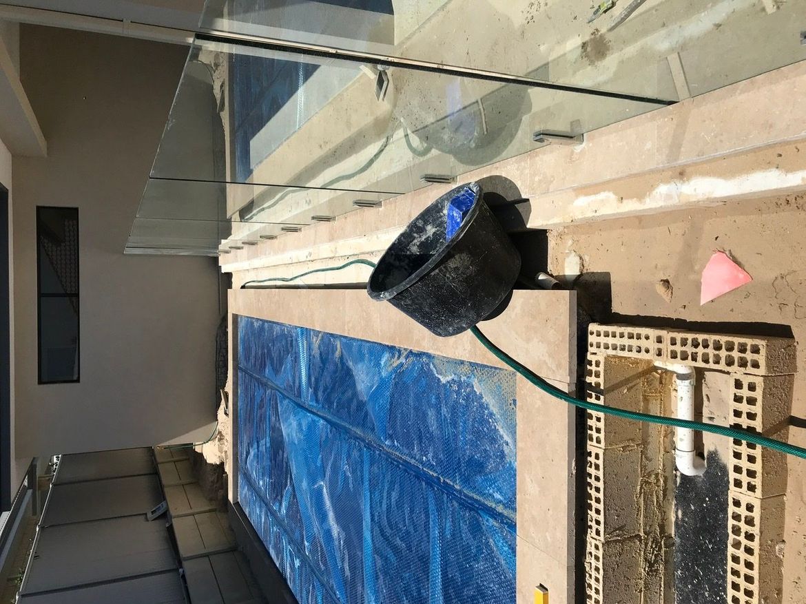

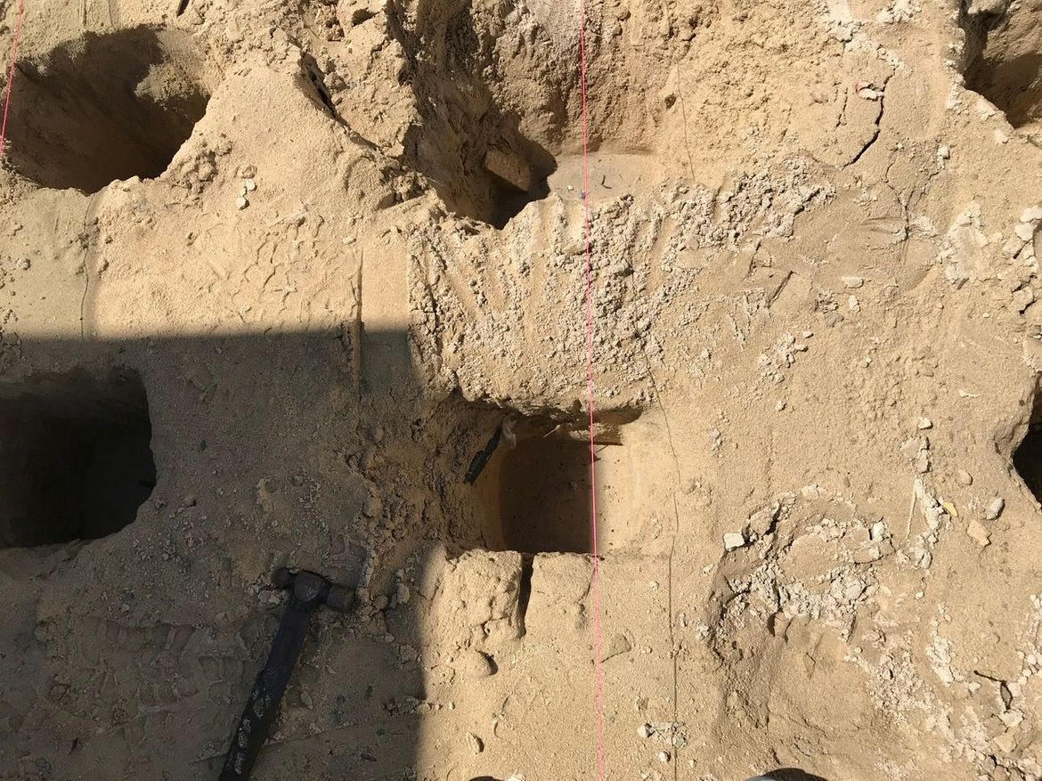

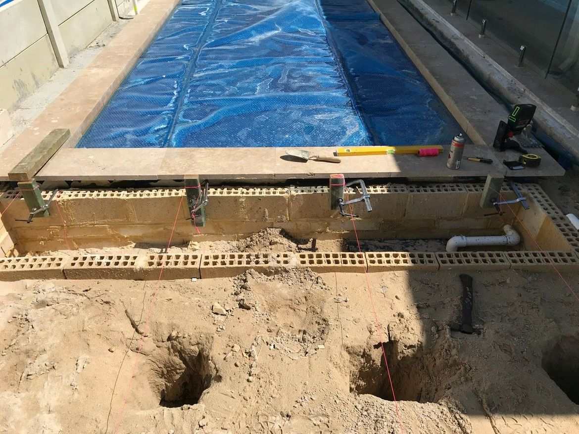

It started out as me wanting a underground pool blanket box. But when the quote came in at $6,000 I decided to give it a go myself.
I laid a foundation for the bricks, leaving the floor area in the box free to allow for rain and pool water to drain into the sandy soil. 100mm of foundation , slightly wider than the bricks, then topped off with bricks & mortar left over from the build. I bought some 40MM Angle and 25MM SHS from Bunnings today to make the trap door and frame to sit on top of the bricks.

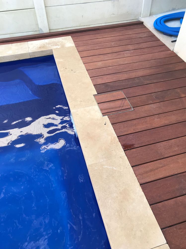

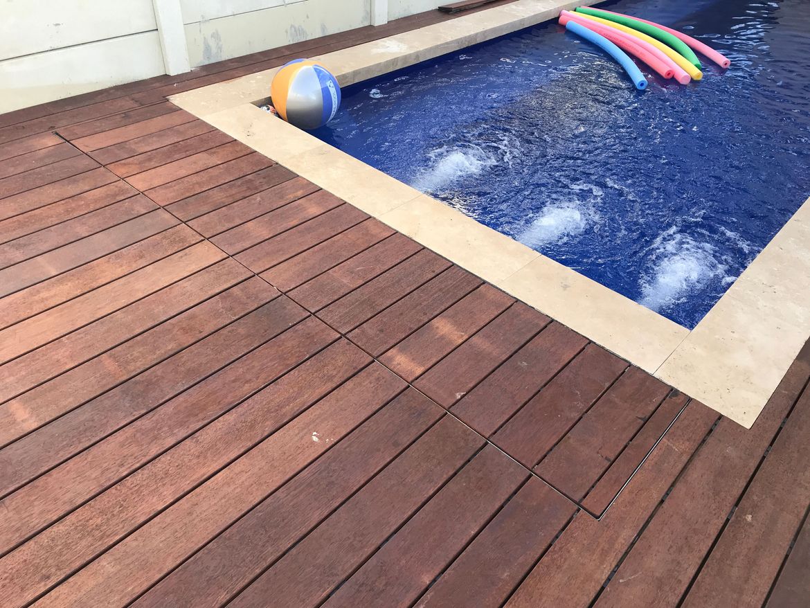

Getting there...
