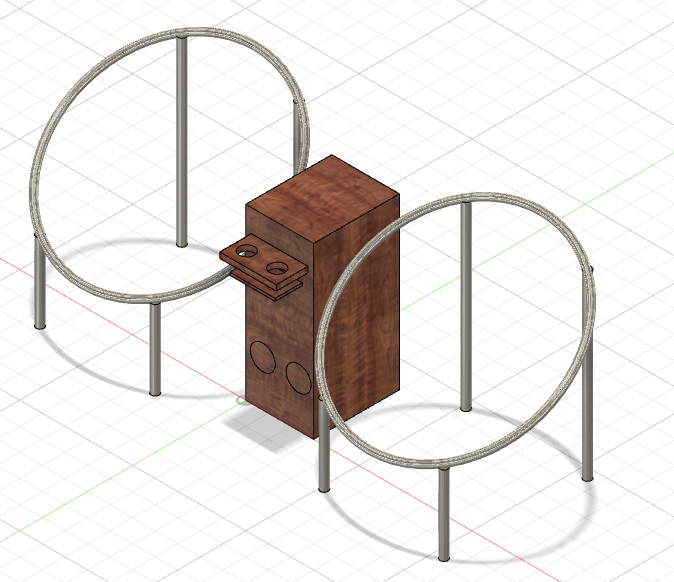

this is what I am building for a school project
I am also looking for some advice on how to make it into this circle shape because the school doesn't have many metalwork tools

Are these going to be Acapulco styled chairs? If so, ours are constructed from something close to a 15mm steel tube.
We have some tube and pipe benders, but I don't believe they'd be any help in this type of project. They're only used for doing one bend, not forming an accurate circle. You'd need a pipe roller bender to form a circle out of the pipe, as far as I'm aware.

As Mitchell has stated you require a pipe form roller that can produce the continuous form then weld the ends together. I suggest you check out the local area for someone who can roll the form for you.

I am in the ACT. I have found a business in the area that can bend and roll pipes, thank you for the reccomendation

It has the same base as an Acapulco style chair but it is going to have macramé as the seating
