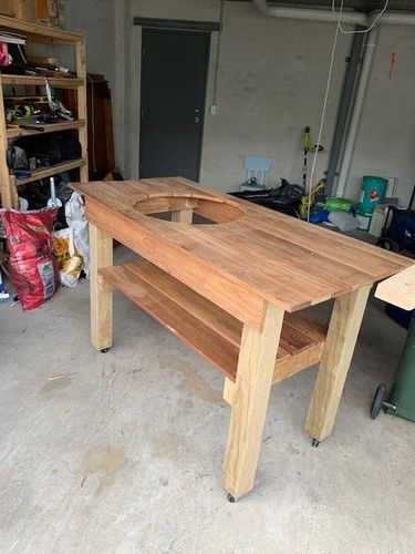

IMG_6112 (2).jpgI have not built anything with wood since I was a child .... and love what I achieved

That's a fantastic BBQ table you have put together there @james73. I trust you are very impressed with your efforts, and rightly so.
Could you provide some details on the project? I trust our members would be interested in hearing what type of timber you used and any difficulties in the construction process.

Thanks Mitchell
Really wanted a table for the BBQ as wanted some prep area wanted to keep it as simple as possible
For legs used 88x88 Dar pin to ensure was flat as possible built remaining frame with 100x50 pine sleepers
Finished with Merbau Decking
Just waiting for it to weatherin then will paint legs back and will finish off the Merbau with furniture oil
hardest but was doing the circle hole and getting the depth tight for the bbq to rest on ....rest was precut at my Local Bunnings store
only equipment needed was jig saw and  drill
