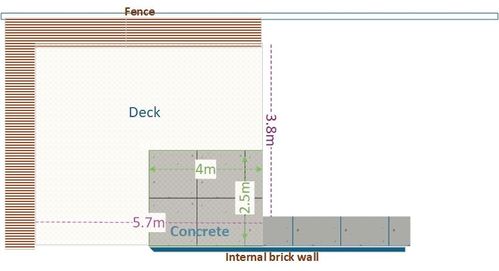

I am looking to do decking project (3.8m *5.7m ) to transform my back yard. The deck runs across concrete and the soil and the major portion lies on concrete. Attached is the plan of it.
Height difference between the concrete slab and the bricks under exist door is 60mm. How to achieve framing (driinage , strength etc ) in this low clearance situation ?

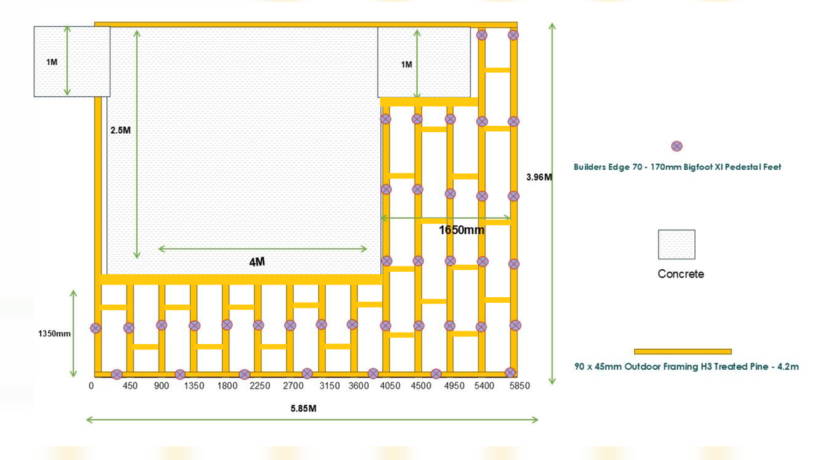

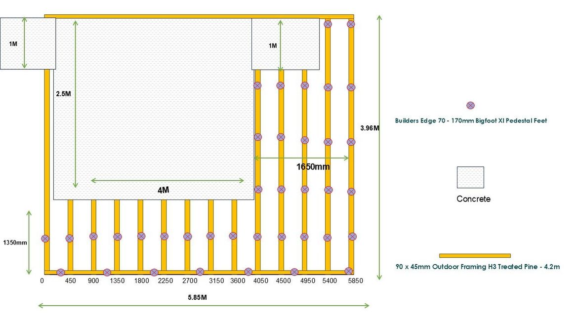

Hey @MitchellMc ,
As suggested I will be using 90*45 H3 Outdoor framing treated pine ,
Big foot pedestal for support on soil , these pedestals will be placed on concrete paving slab
for stability.
I have put together a plan on how these materials will be placed on the surface. Do you think this would work interms of strength ?
Re: Need framing suggestion for low level deck
Hi @nvelaga,
That looks well supported.
You might like to add some additional framing where the joists meet the concrete. You should also add noggins between the joists to stabilise them.
