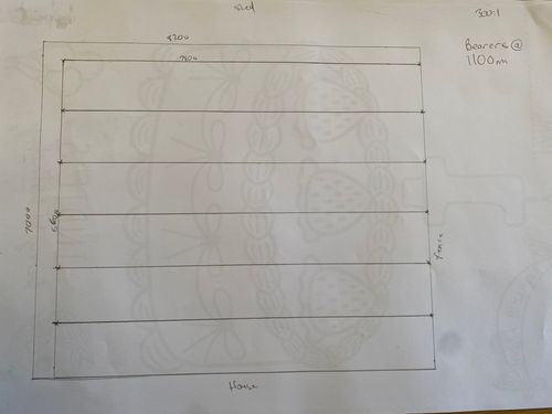

currently planning to build a deck as part of our backyard project.
the deck will be completely over soil and I have a septic pipe to deal with running underneath.
total deck is is 7000 x 8200 inclusive of a 400mm step wrapping around 2 sides, height is avg of 310mm. One side is the house and another side is a fence.
I have read through some of the projects here and this has helped a lot (thanks contributors!) but I have some questions.
- do all my supports need to be concreted or can I get away with some being on firm ground? Soil is hard and clay
- I have set bearers @ 1100, what size should be used and how best to cover the span?
I have not undertaken a project of this scale before but can handle diy projects no problem any help or advice would be great. Look forward to tackling this and posting the progress.
