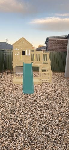

Recently bought cubby house from Bunnings but unsure how and where to start. Does it need any base separate before I install if so what base needed? If not can I start fitting how it going to fix with soil?
I have attached imaginary picture on backyard how will look like. We already have pave stones in backyard. Thinking to remove on area were planning to place cubby house.
I would really appreciate your ideas.
Thank you,
Gaurav.

Thanks for the update and for sharing more about your project — it’s great to hear you're moving ahead with your cubby house plans. When it comes to installation, it's important to follow the directions provided with your cubby house, as different models have different requirements. Some are designed to be pinned or anchored down, while others are freestanding and simply need a stable, level base, particularly larger cubby houses that aren't easily tipped over.
In terms of preparing the site, if you’re removing the existing pebbles and exposing the weed mat underneath, that’s perfectly fine. You can lay the rubber pavers directly on top of the weed mat, and they will provide a soft and safe surface for children to play on. As for securing the cubby house, refer to the instructions that came with your kit — it may not require anchoring at all, or it might need to be fixed to a timber base or directly to the ground. If you’re unsure, feel free to share the brand and model of the cubby house or any details from the manual, and we can help you work out the best way to set it up securely.

Thank you for identifying which cubbyhouse you'll be putting together. According to the assembly instructions nothing must be placed under the cubby house. It would be safe to conclude that the area you'll be placing the cubbyhouse in must be totally flat and levelled. The rubber pavers must be placed around the cubby house structure where the children will be playing in all directions for two meters. The instructions also mention to use weights such as sandbags or steel pins to anchor the structure to prevent it from being carried away by strong winds.
Please have a good look at the assembly instructions and if there is anything you would like to clarify, please let us know.
