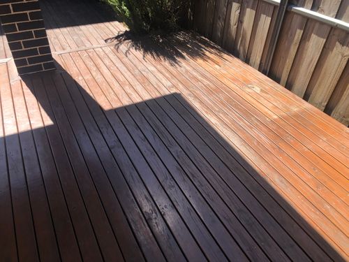

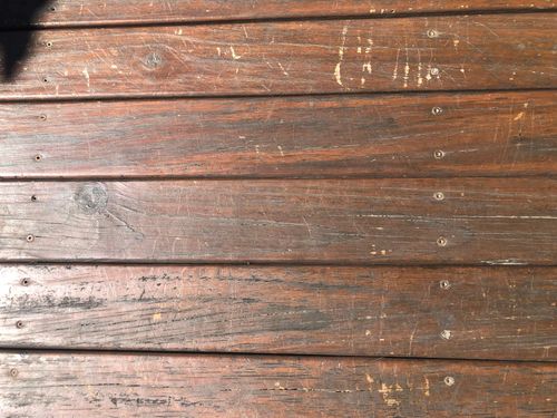

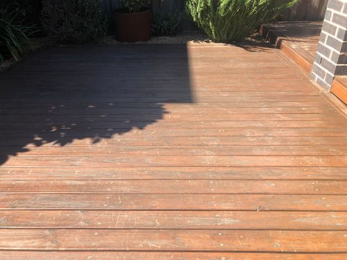

I just moved into a new house and need to re-oil the spotted gum wooden deck for the first time.. part of the deck is covered and the other part is open.. I have intergrain decking oil. I had a few questions before I start.
1. Do I need to sand my deck before oiling ? If so should it be done before cleaning or after. And also what grit sandpaper should I be using.

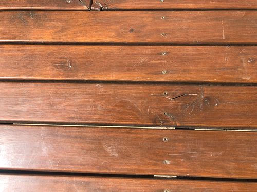

2. Do I need to fill in the cracks before oiling. I don’t see any major cracks. But the exposed part of the deck seems to look worned out.
3. What deck cleaner can I use for cleaning the deck.
4. Should 2 coats of oil be good enough if I plan to re-oil every 12 months?
5. In general, What is the best way to keep the deck looking clean and shiny between the oil coats.
Looking forward to hearing from the experts

1. It looks like your deck is on the borderline between needing to be sanded and not. You could re-coat, but there is a fair amount of scratching on the surface. Although the oil would disguise the issue, sanding would be needed to remove the damage. If you do go to the effort of sanding it, the result will be amazing. The sanding process will remove most of the grime from the surface and will leave you with fresh timber ready to be oiled. You'll start with 40-grit sandpaper and move on 120-grit for a smooth finish. If you sand you shouldn't need to clean, though it might still be a good idea to remove any debris from the sanding process.
2. I'd suggest filling large cracks prior to standing, as since the putty will need sanding too, it makes sense to do it all at the same time.

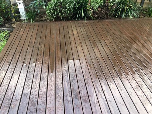

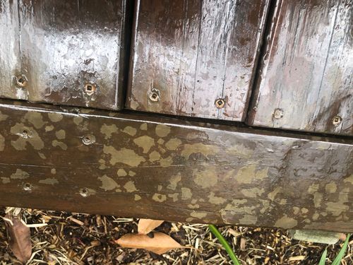

Hi All,

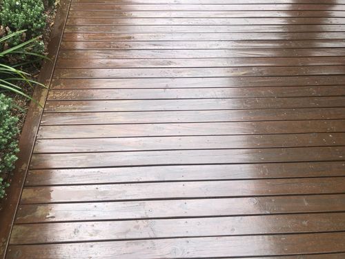

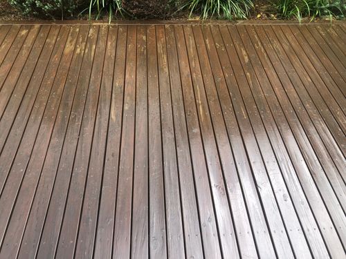

I skipped sanding the deck this time around and went ahead with the cleaning and oiling process.. the deck looked nice and shiny after completion. It got enough drying time 1-2 days before some dust accumulation on e deck and some rains.
Its 1.5 weeks later, and the water seems to be stagnating on the deck. Once it dries, they leave water marks everywhere and there are some weird yellowish stains as well on the deck as shown in the pictures. Also I am able to peel off the yellow stains.
Is there something wrong ? Or does it usually take some time for the deck to get back to normal.
Re: Need some advice before re-oiling my wooden deck
Hi @AarKay,
I'm sorry to hear you're experiencing issues with your newly coated deck. Could you please provide some details on the product you used on the deck? That will give us a better idea of what the problem might be. At first glance, it appears as a deck that didn't have sufficient drying time before being exposed to rain. At a minimum, you'd need 48hours of drying time before the deck can be exposed to rain. The yellow makes are likely areas where the rain has penetrated the timber and displaced the oil/stain.
I look forward to hearing what product you used so I can investigate further.
