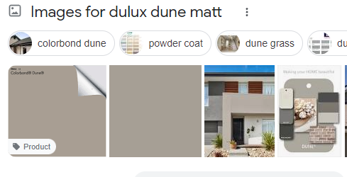

I love the paint colour that you chose to paint the timber, are you able to share the name of it?

Hi @KTW  I agree with @KatieC this will be inspiring for other members. It's good to see that you built this mobile veggie stand, I like the idea of making it mobile and no bending or kneeling, wishing you a great harvest, now just sit back and wait for the reward.
Is the colour , Dune
