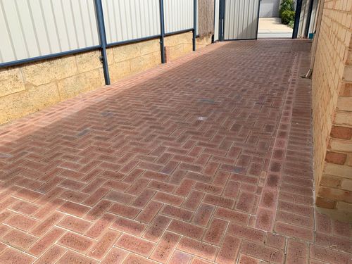

One of my recent paving jobs

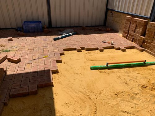

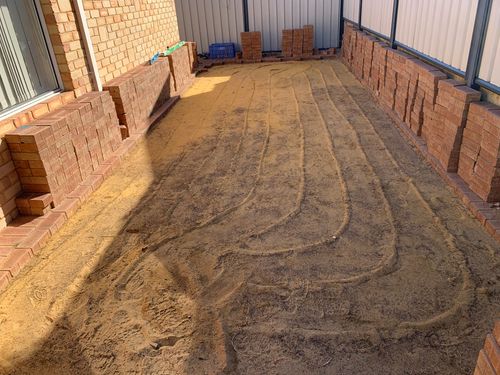

Hi there, what did you use as the base please? And how thick?
Yorky88
Super Contributor
Re: One of my recent paving jobs
Hey @jose29  I Compacted the existing sand and just put roughly 30mm of brickies sand over the sand that was already there. Are you planning a paving job?
