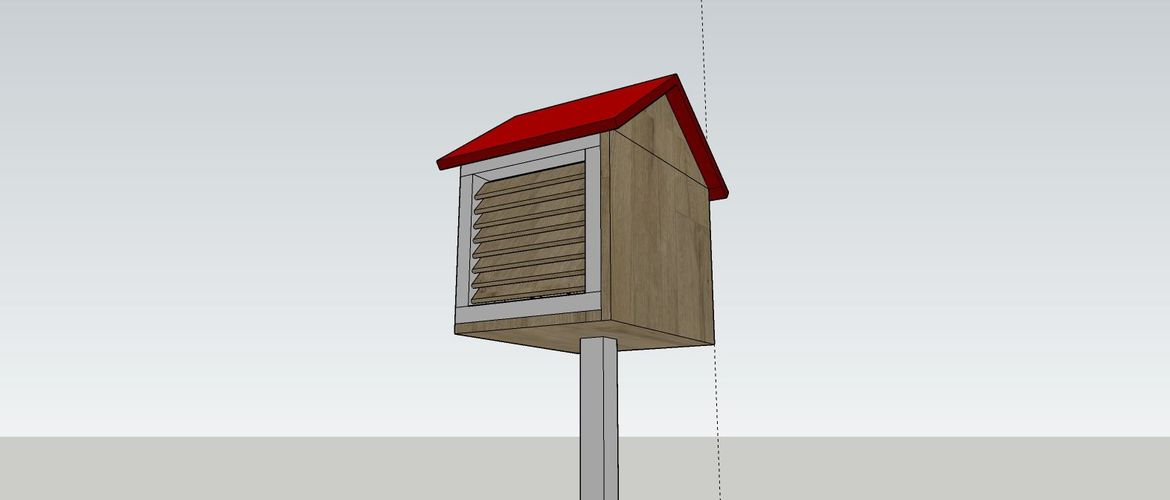

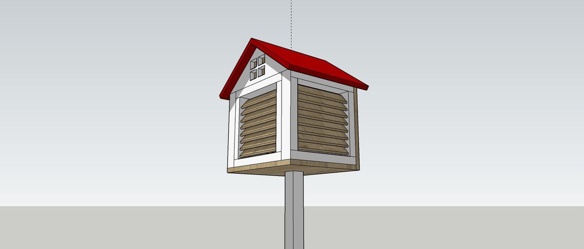

It would be reasonably easy to create an attractive-looking enclosure to house your weatherproof powerpoint. You might need to route the frame of the unit to accept the slats. I would imagine creating a jig would be the best approach allowing you to repeat the same identical cut for all the slats. I've thrown together a render of an option, and it looks like it would be a great weekend project. Were there any particular designs you had in mind?

@MitchellMc
Something like that is pretty much what I had in mind.

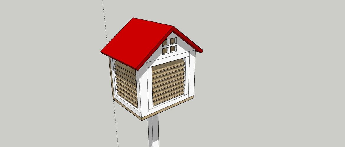

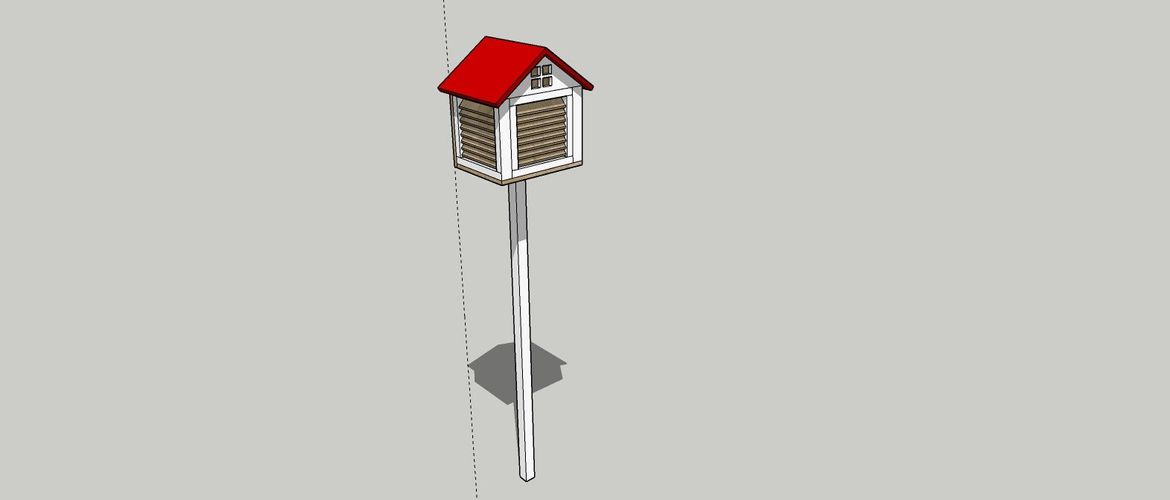

Welcome to Bunnings Workshop. If there was ever a time to try your hand at DIY now's the time! This project can be made in many ways and does not have to look like the stuff we draw here. It all boils down to planning and preparation if you have the time then this particular DIY project should be a great starter project for you. Plus it is a great excuse to buy tools and build up your experience in using them. Below is my suggestion for your weather station pretty close to @MitchellMc 's suggestion I just opted for the gabled roof. You can make this more practical by attaching shelves to the post and putting potted plants on them to make it more attractive. Enjoy the drawing and ponder the possibilities! Oh and if you do build it make sure to put mozzie mesh inside to make sure you don't get any uninvited guests. It also makes a great hiding spot for the spare key!

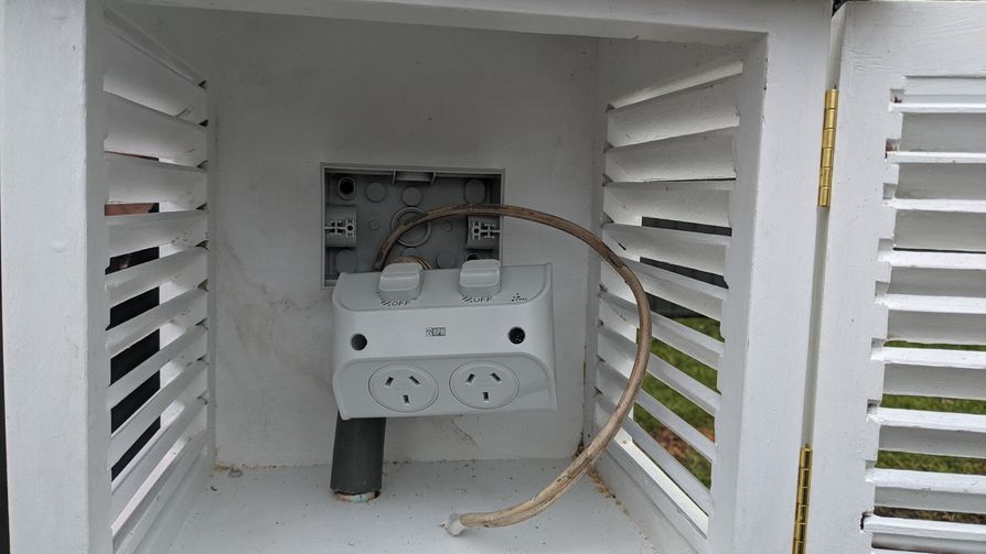

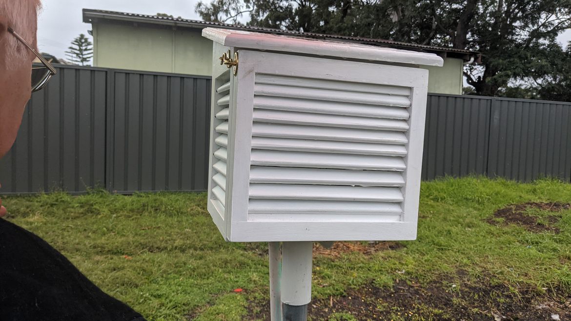

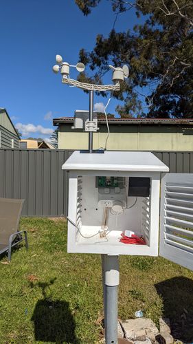

Well,  We've put it up and tested it.
As originally told, I wanted to use the old power conduit from the old shed.  So, that's fine.
I had a mate do the woodwork, my Brother in Law do the electronics (he's the certified sparky).
We put the assembly together today. We decided to add a light to the fixture, which is coming soon, since we have a light conduit
My part of the project for this, which I have mostly completed, is an Arduino based weather station, which will be WiFi connected and report Temp, Humidity, Pressure, Rainfail and (stretch goals) Air Quality and Lightning), and make it available online to anyone via WeatherUnderground.
Right now, it's powered via the normal 240volts with a 9V adaptor, and not fully setup, but I plan on adding a Solar Panel and a chargeable battery so it's independent of the powerpoints.
Many thanks to @redracer01 and @MitchellMc   for the design ideas, as you can see we have combined the suggestions.
More updates as we get it finished.
Electrician and carpenter ( the real workers)

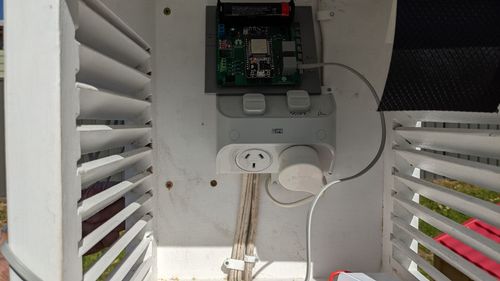

Internals before connection

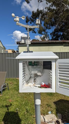

I settled on a Diyode article DIY Solar Powered WiFi Weather Station  because while I had power there, I wanted to make my first solar powered circuit.
The original Solar Powered WiFi Weather Station  is just brilliant and has an active community helping, and writing code (sorry about mentioning coding - it's part of what I do.🤣)
You can buy the windvane and anemometer from Mouser or other places  I chose the Sparkfun  module, since the community was using it, and it was the fastest to ship to me.
I added a few different sensors than the original, just more sensitive, and I want lower power consumption if I can get the project working longer on a single solar battery charge.
Anyone with a small amount of soldering skills can do this, and simply copy the code from the community, BTW.
I 3D printed a circuit board mount, but it's not really necessary - it just looks neater, and I can remove the circuit board to reprogram the modules as I improve things.
Internal before connecting it all up. The plug on the right is currently connected to a "fridge lamp" which gives off a nice look in the evening If I turn it on. Note the sockets are weather proof.

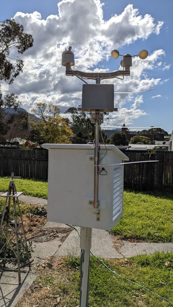

To mount the anemometer, rain gauge and solar panel we drilled a hole in the back of the box, fed the cables through, and used silicon sealant to weather proof it.
Some stirrup clamps, wooden chocks, and a rubber stopper keep it all perfectly vertical and solid.

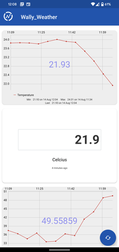

My internet feed for the weather station is Here  and I also have a ThingView  app feed to my android phone:
The coding to make a wind direction compass is quite complex I've found, and a bit beyond me at the moment, so I'll have to stick with the current gauge that thingiverse supplies until I can understand the code.
